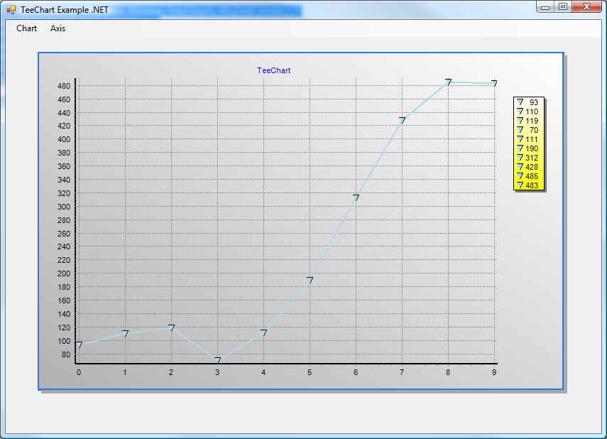

I draw a line series in my chart with PointMarks visible. The style for the PointMarks is DownTriangle.
I am using TeeChart .NET v2009, where I notice that the left border of the triangles is not drawn.
In the attachment of this post, you can see the screenshot of my problem.
My sample code to reproduce this issue:
Steema.TeeChart.Styles.Line line = new Steema.TeeChart.Styles.Line();
line.Color = System.Drawing.Color.LightBlue;
line.LinePen.Color = System.Drawing.Color.LightBlue;
line.LinePen.Width = 2;
line.Pointer.Visible = true;
line.Pointer.Style = Steema.TeeChart.Styles.PointerStyles.DownTriangle;
m_tchart.Series.Add(line);
Is this a known issue?
Marijke.
Screenshot for DownTriangle issue
Re: DownTriangle PointMark without left border
Post by Narcís » Thu Feb 18, 2010 4:04 pm
Hi Marijke,
Yes, this is a known bug (TF02014652) which has already been fixed for next TeeChart for .NET 2009 maintenance release which is due out imminently.
