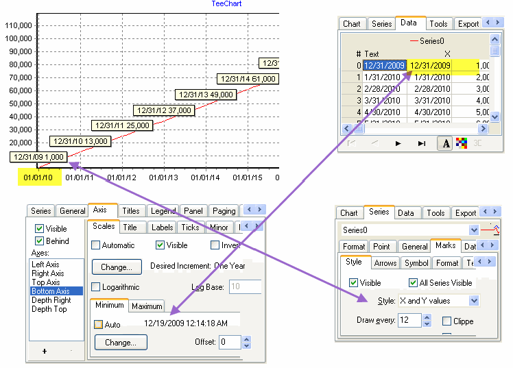

Hi Im using Techart Active X v7.0.1.4. It’s hard to understand how Teechart is handling date series!
In my sample there are 120 month end date points. I insert them into the chart with the Addxy() method.
1 ) Problem showing values on the bottom axis increment 1 Year:
Date values 1 year
As you can see on the bottom axis the correct dates are not shown. I wonder also where the minimum value is coming from?

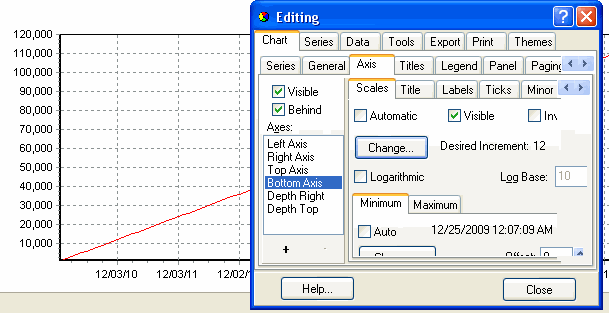

2) Problem showing values with 12 points
Date values 12 points

Hi Henry,
I think that the following example reproduces your problem:
Private Sub Form_Load()
  TChart1.Aspect.View3D = False
  TChart1.AddSeries scLine
  TChart1.Series(0).XValues.DateTime = True
  Dim mymonth, myyear As Integer
  Dim mydate As Date
  For myyear = 2009 To 2010
    For mymonth = 1 To 12
      If mymonth = 2 Then
        mydate = "28/" & Str$(mymonth) & "/" & Str$(myyear)
      Else
        If (mymonth = 1) Or (mymonth = 3) Or (mymonth = 5) Or (mymonth = 7) Or (mymonth = 8) Or (mymonth = 3) Or (mymonth = 12) Then
          mydate = "31/" & Str$(mymonth) & "/" & Str$(myyear)
        Else
          mydate = "30/" & Str$(mymonth) & "/" & Str$(myyear)
        End If
      End If
      TChart1.Series(0).AddXY mydate, mymonth + (myyear - 2009) * 12, Str$(mydate), clTeeColor
    Next mymonth
  Next myyear
  TChart1.Series(0).Marks.Visible = True
  TChart1.Series(0).Marks.Style = smsXY
  TChart1.Axis.Bottom.Labels.Style = talValue 'talText
End Sub
Note that TeeChart calculates internally the labels to show trying to show as many labels as possible. You can:
- Change the bottom axis bottom style to talText. This will force the bottom axis to show the labels stored with the series values (hiding the necessary labels to avoid overlapping).
So you'll need to add your values with label (or assign them manually once added) or use OnGetAxisLabels event to format your axis labels text.
- Use custom labels. You can clear all the bottom axis labels and add as many as you want manually (TChart1.Axis.Bottom.Labels.Clear and TChart1.Axis.Bottom.Labels.Add methods)
