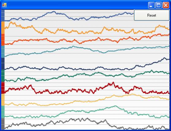

I have made a small example so that you can understand the problem.
Below are few screen shots of the application.

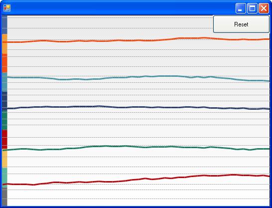

Before zooming - (Look at the custom axises at the left side) After zooming - (Number of custom axis visible is still 10. although only one series is visible.) One more -
Project is attached here - Regards,

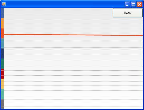

One more screeshot below -
Here also - all the custom axises are in the same position even though the series associated with few of the custom axises are not visible (Out of visible area). What we need is - the custom axises should be resized based on the series data values.
If the series is fully visible then the custom axis should be there with proper size. If only one series is visible then the custom axis associated with that series should be the only axis visible and should take the whole area. Means the start and end position should be - 0 and 100.
Similarly, now if 2 data serieses are visible and some portion of a third data series is visible then the custom axis size that is associated with the data series that is partially visible should not be of the same size as other axises.
In that case the custom axises size should be based on the data series visibility.

Re: Custom Y axises are not resizing after zooming
Hello Avijit,
I could reproduce your problem. I think it occurs when you do SetMinMax(), because position of FastLine Series don't paint correctly. Do you need to do SetMinMax() necessarily?
Because, looking at your code, I see that really you don’t need use SetMinMax() function, because labels don't appears and axes resizing although you don't do SetMinMax(). Therefore, if you don't need to do SetMinMax() I suggested remove it. But if I was wrong, please let me know, because we will try find a solution using SetMinMax () function.
On the other hand, please could you check if you are removing the events lines are drawing correctly?
I hope will help.
I hope will help.
Hi Sandra,
Avijit
Yes. I require this SetMinMax() function call for zooming in and resizing the Custom Axises. And resizing of Custom axises are also very important because - the size and screen location of the custom axises determines the size of few objects that i am drawing inside the control. The objects size is directly related to the size of the custom axises.Do you need to do SetMinMax() necessarily?
Sorry i did not understood that part.On the other hand, please could you check if you are removing the events lines are drawing correctly?
Avijit
Hello Avijit,
I rewrite your code and I think that I have found a solution that do as you want. Please, you could check that code I have added in this post works correctly ans alse works as you want.If you do not understand something, please you tell us.
- NoResize1.zip
- (11.04 KiB) Downloaded 951 times
