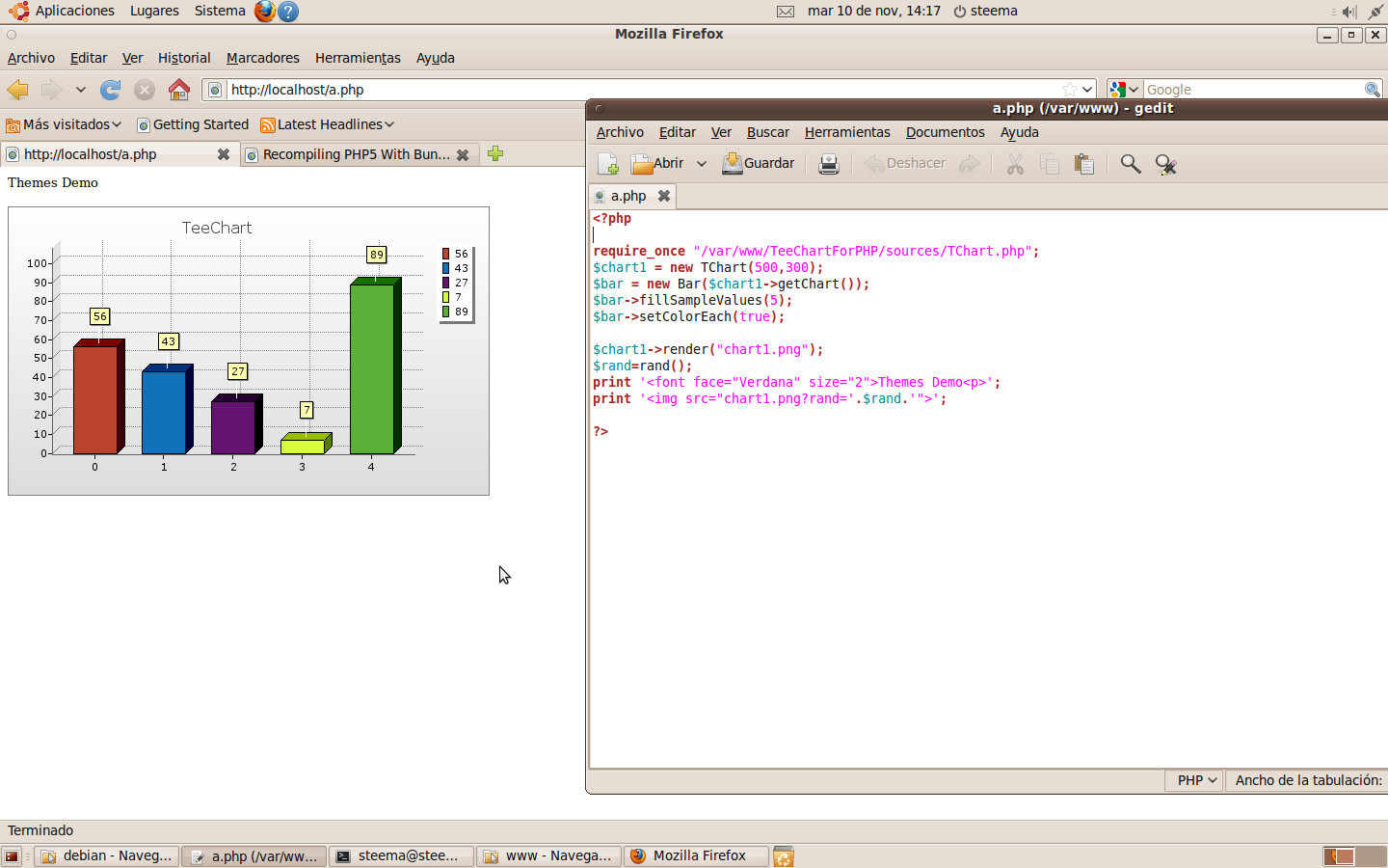

Yes, I've made a test in a fresh install of Ubuntu 9.10 the last week and I've found some problems with GD library but I managed to run it by recompiling the PHP following this instructions.
See the attached example that worked for me here: And the result: What we haven't tried is in 64 bits.

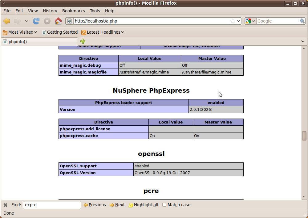

"file /var/www/TeeChartForPHP/sources/TChart.php requires Php Express loader to be installed by the web site administrator."
If I...
- Download http://www.steema.com/products/teechart ... oaders.zip
- Unzip the phpexpress-php-5.2.so file from loaders.zip/loader/phpexpress-2.0-Linux-glibc-2.7.tar.gz/phpexpress-2.0-Linux-glibc-2.7/x86/ to /var/www/extensions/
- Edit the php.ini file to load the phpexpress extensions:- - sudo gedit /etc/php5/apache2/php.ini
- - At line 508: extension_dir = "/var/www/extensions/"
- At line 621: extension=phpexpress-php-5.2.so

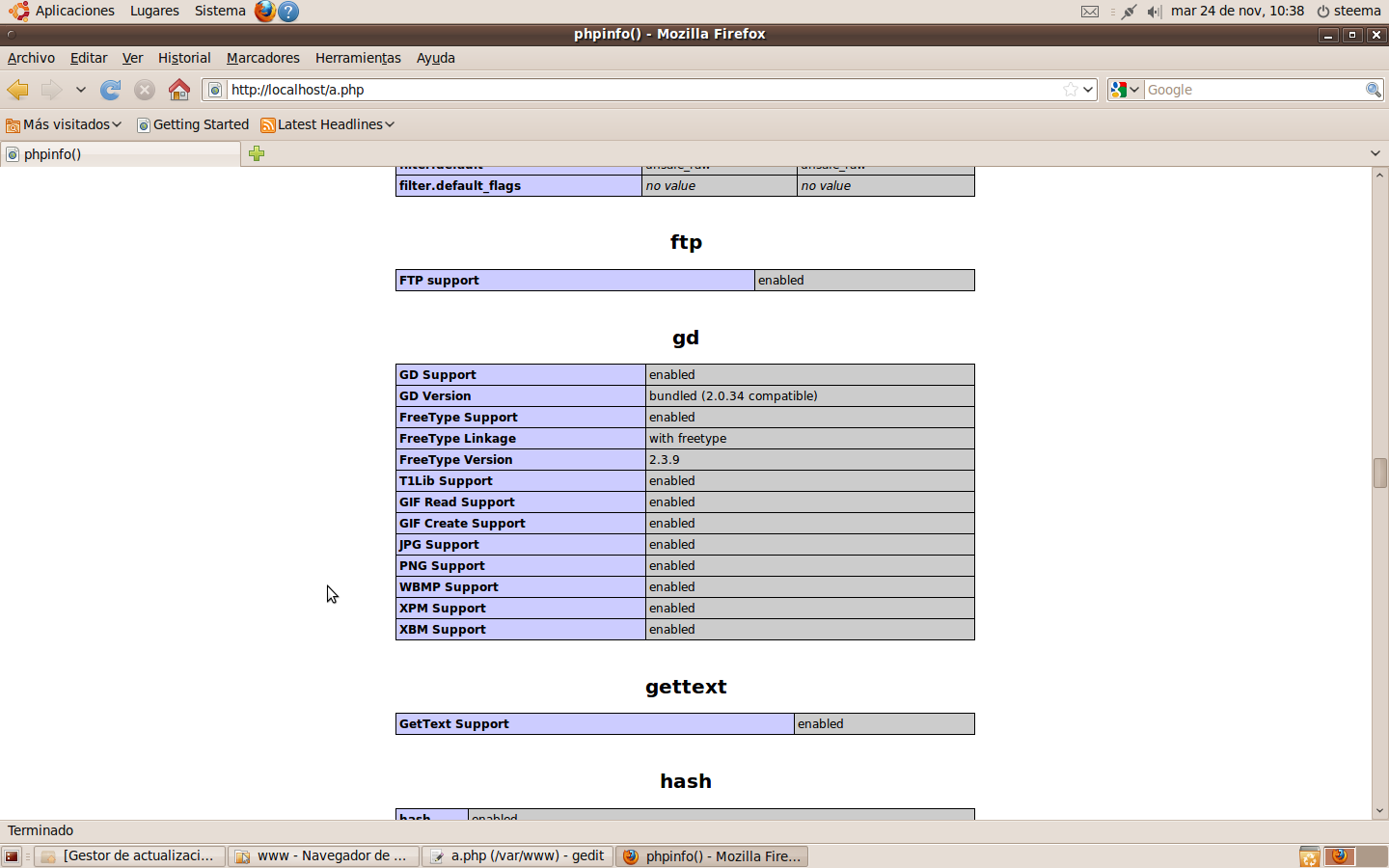

Fatal error: Call to undefined function imagecreatetruecolor() in /var/www/TeeChartForPHP/sources/GraphicsGD.php on line 698
To solve this, we have to recompile php5 as explained in the web said above:
- sudo apt-get install build-essential debhelper fakeroot
- cd /usr/src
- sudo apt-get source php5
- sudo apt-get build-dep php5
- cd php5-5.2.10.dfsg.1
- sudo gedit debian/rules- at line 220: --with-gd=shared --enable-gd-native-ttf \
- cd ..
- sudo dpkg -i php5-gd_5.2.10.dfsg.1-2ubuntu6.1_i386.deb
At this point, having enabled the nusphere loaders, the GD library isn't loaded successfully and it gives me an error so I had to comment the lines I've added in the php.ini
- sudo /etc/init.d/apache2 restart
Now you should see a chart if you open a browser and call http://localhost/a.php - - sudo gedit /etc/php5/apache2/php.ini

I assumed that the phpexpress loaders weren't needed at all. But maybe recompiling the php with them enabled has something to say here...
Yes. Excuse me if I confused you. As I had to disable the loaders at the end of the process, I thought I could skip that in my "installing instructions".streamfoundry wrote:Interesting, Yeray - that you got the same error I did originally, saying that TChart.php needed the PhpExpress loader. You installed one and apparently got by that error because you then got a later error in GraphicsGD.php.
Yes, in a few words the process I made was:streamfoundry wrote:Yet, after recompiling PHP for enabling GD support, you disabled the loader and didn't get the original error back? Pretty strange.
- error of phpexpress loaders -> enable phpexpress loaders
- error of GD library -> recompile php
- error of GD library -> disable phpexpress loaders enabled before
Of course, here it is:streamfoundry wrote:Do you have a copy of the resulting php.ini extension statements?
After loading them in the beginning of the process, I could see them enabled running the phpinfo function. And at the end of the process, after removing them from the php.ini, I can't find them in the phpinfo function result, but the chart seems to work without problems.streamfoundry wrote:You sure the extension=phpexpress-php-5.2.so statement isn't still in there?
Yes, I'll try to clarify any step in my installation you could find problems with. Also, I can try to upload the vmware virtual machine where I have the "working" ubuntu, if you want to take a look at it.streamfoundry wrote:In any event, I'd like to follow your install exactly so I still need a z-platform PhpExpress loader before I can go any further.
