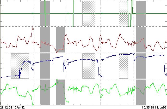

I have used the Annotation tool for highlighting a section of data in my chart control.
I have 10 Fastline series data. User can move the mouse at the bottom of the control to select or highlight a section of data.
I have to provide the top, left, height and width to the Annotation tool for highlighting the data.
See the image below.
Now, when i am zooming the trend control - the Annotation tool is not getting resized. In the below image, i have zoomed the data but the Annotation tool is still of same size.
In the RectangleTool this problem is not there. It is only specific to Annotation tool.
Can you suggest me a way to solve this problem.

Please let me know if i can specify the left, width, top and height of the ColorBand tool.
Please have a look at the screenshot below from our own product that has been developed using MFC-
Now let me know if it is possible to use the ColorBand tool to do these kind of highlightings in TeeChart control.
I think ColorBand tool is always associates with a axis. It is really a disadvantage of the usage of the tool.
For the markings shown in the screen shot i have to specify the left, width, top and height for the tool.
Please let me know if you have any alternative solutions for this problem.
Also please allow the users to specify the left, width,top and height of the ColorBand tool. It is really required.
