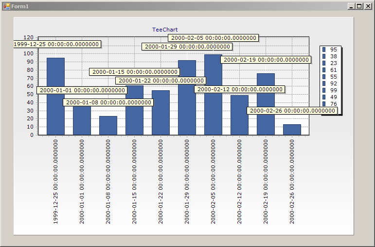

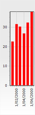

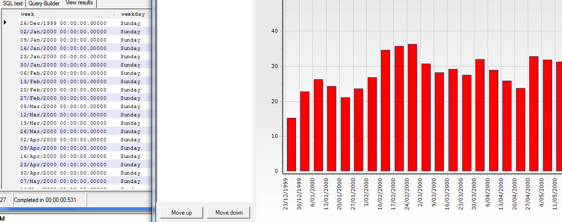

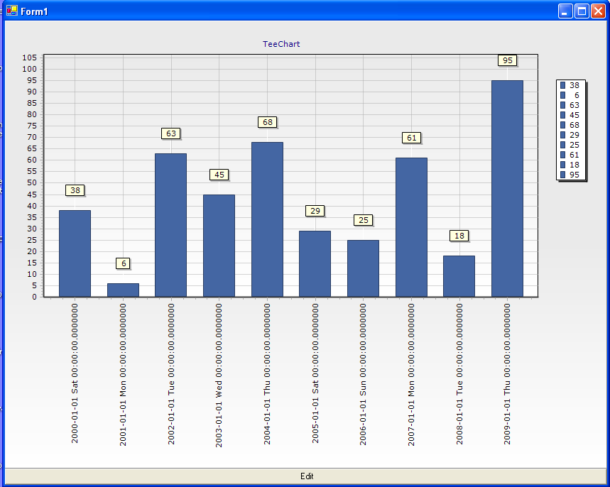

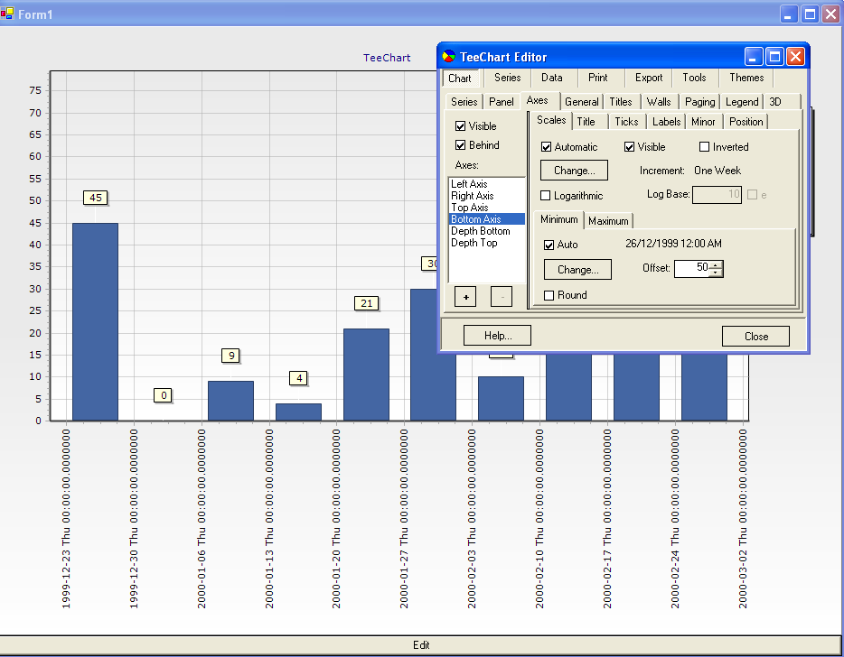

Thinking about this problem further I think the issue may be around how you are now setting the start date of the series, i.e. the axis label for the first bar. The following shows my data and the resultant chart.
As can be seen the first date in my data is 26/Dec1999 which was a Sunday. When plotted the first date on the axis is 23/Dec/1999 which is a Thursday. I think the problem would be resolved if you went back to setting the first axis label to the first value in the data,then applying the standard increment, especially when the axis definition is using a standard datetime interval. My axis definition has the start and end of the axis set to automatic and the interval stet to one week.

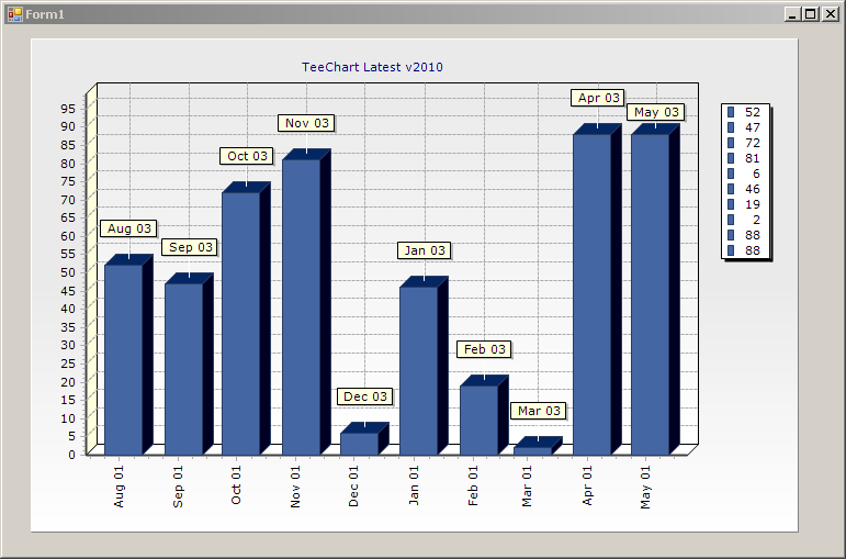

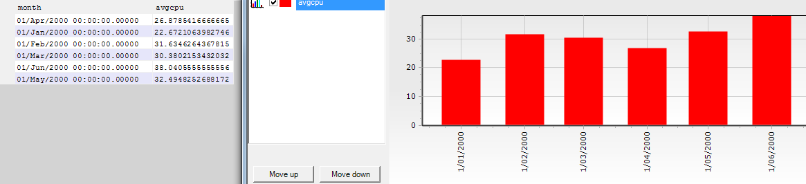

Consider also that this problem doesn't exist if monthly data is used. See the following examples
the following shows the monthly chart resized so that less axis labels are shown, they still stay resolutely aligned with the bars. The weekly chart is almost impossible to get the axis labels to align with the bars.
I'm sorry about going on about this problem but its a real issue for me, I need the labels to align correctly with the bars when using datetime data with standard intervals as they have done so in the past.

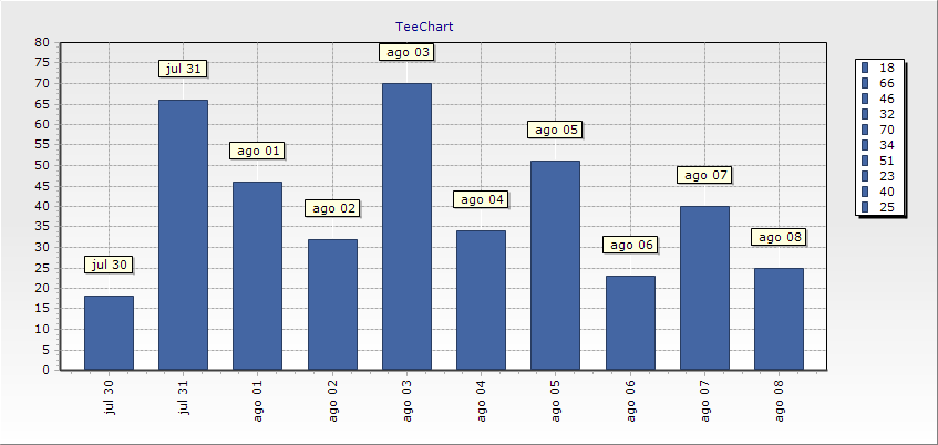

I think you could use axis labels style Text and capture the GetAxisLabel event to show the XValues so you won't need to add you values with label:
            Steema.TeeChart.Styles.Bar bar1 = new Steema.TeeChart.Styles.Bar(tChart1.Chart);
            bar1.Marks.Style = Steema.TeeChart.Styles.MarksStyles.XValue;
            tChart1.Axes.Bottom.Labels.DateTimeFormat = "MMM dd";
            tChart1.Axes.Bottom.Increment = Steema.TeeChart.Utils.GetDateTimeStep(Steema.TeeChart.DateTimeSteps.OneDay);
            Random rnd = new Random();
            DateTime date = DateTime.Now;
            for (var i = 0; i < 10; i++)
                bar1.Add(date.AddDays(i), rnd.Next(100));
            bar1.XValues.DateTime = true;
            tChart1.Axes.Bottom.Labels.Style = Steema.TeeChart.AxisLabelStyle.Text;
            tChart1.Panel.MarginBottom = 15;
            tChart1.GetAxisLabel += new Steema.TeeChart.GetAxisLabelEventHandler(tChart1_GetAxisLabel);
        void tChart1_GetAxisLabel(object sender, Steema.TeeChart.GetAxisLabelEventArgs e)
            if (sender == tChart1.Axes.Bottom)
                if ((e.Series != null) && (e.ValueIndex > -1))
                    e.LabelText = DateTime.FromOADate(e.Series.XValues[e.ValueIndex]).ToString("MMM dd");

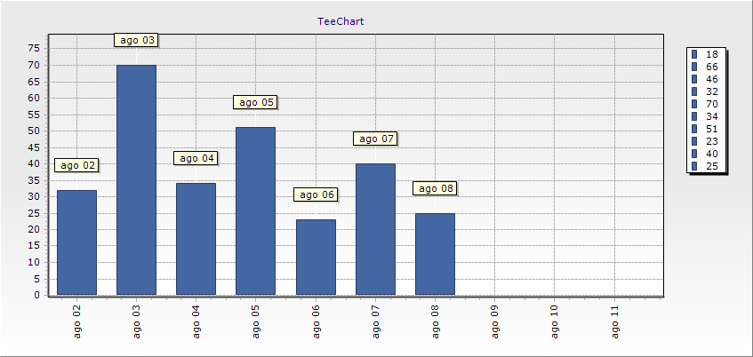

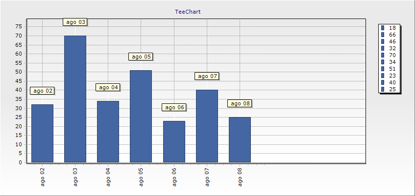

The two examples above give the same result in a first view:
But when you scroll the chart, you can see how the IncrementOffset solution still produces labels where there aren't points:
While the GetLAbels event solution doesn't continue drawing labels where there aren't points:

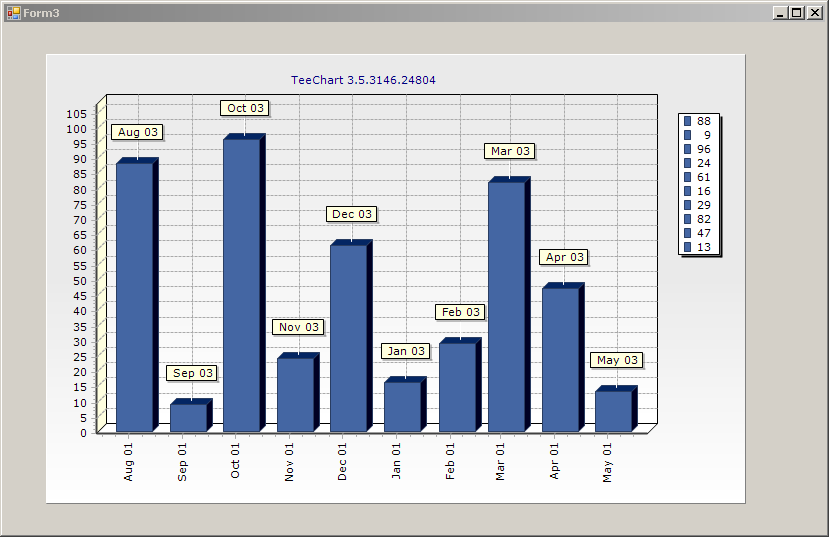

Hi, I'm the lead dev on TeeChart for .NET. This is the code I'm running:
      tChart1.Clear();
      var bar = new Bar(tChart1.Chart) { Marks = { Style = MarksStyles.XValue } };
      bar.XValues.DateTime = true;
      tChart1.Axes.Bottom.Increment = Utils.GetDateTimeStep(DateTimeSteps.OneMonth);

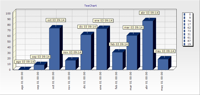

      var rnd = new Random();
      var date = DateTime.Now; //code run on 3rd day of month, hence the offset
        bar.Add(date.AddMonths(i), rnd.Next(100));

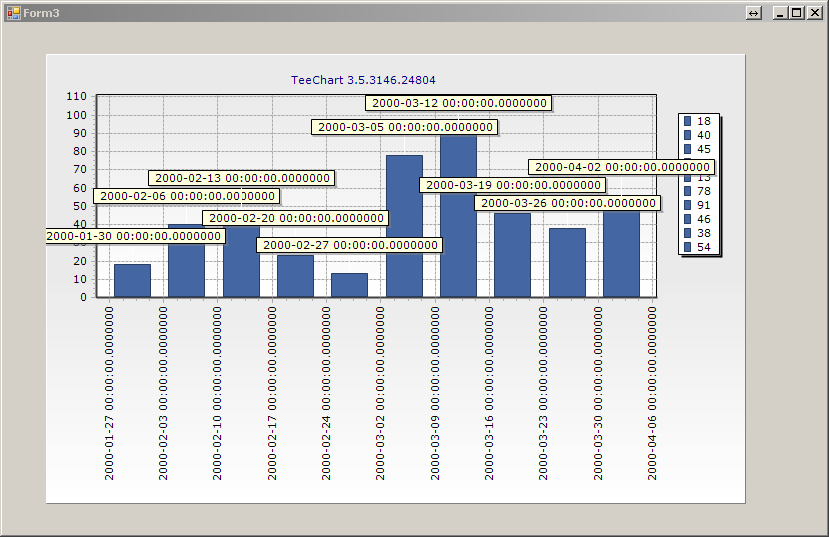

This is what I get using TeeChart for .NET v3.5.3146.24804 in VS2008:
And this is what I get using the latest version of TeeChart for .NET v2010 in VS2010:
I can see no difference between these two images. Can you please run the above code at your end and confirm for me that both v3.5.3146.24804 and the latest v2010 give virtually identical results?
Many thanks.

Please note that in the images I sent, the monthly data is NOT working fine. Can you see that the bottom axis ticks and labels are not exactly in the middle of each bar? This is a symptom of the same "problem".
You didn't post any code for weekly data, but I'm using the following:
      tChart1.Clear();
      tChart1.Axes.Bottom.Labels.DateTimeFormat = "yyyy-MM-dd HH:mm:ss.fffffff";
      tChart1.Axes.Bottom.Increment = Utils.GetDateTimeStep(DateTimeSteps.OneWeek);
      var date = new DateTime(2000, 01, 30, 0, 0, 0, 0);
        bar.Add(date, rnd.Next(100));
        date = date.AddDays(7);
This code was run with Region and Language Format set to "English (United States)". This is the result using TeeChart for .NET v3.5.3146.24804 in VS2008:

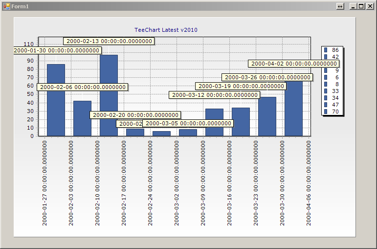

And this is the result using the latest version of TeeChart for .NET v2010 in VS2010:
Again, with respect to the positioning of the bottom axis labels, there is no visible difference. Can you please confirm these results at your end?

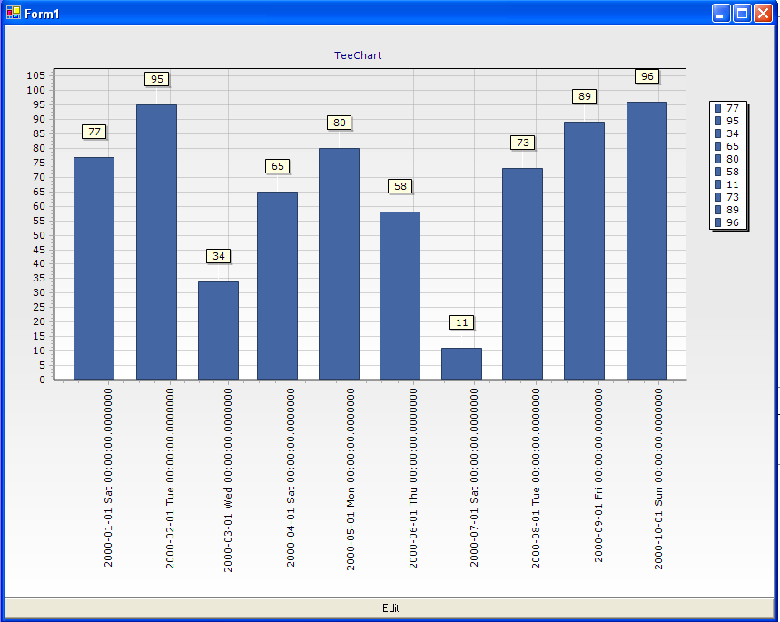

The following code
  Private Sub InitializeChart()
      TChart1.Clear()
      TChart1.Aspect.View3D = False
      Dim bar = New Steema.TeeChart.Styles.Bar(TChart1.Chart)
      bar.XValues.DateTime = True
      TChart1.Axes.Bottom.Labels.Angle = 90
      TChart1.Axes.Bottom.Labels.DateTimeFormat = "yyyy-MM-dd ddd HH:mm:ss.fffffff"
      TChart1.Axes.Bottom.Increment = Utils.GetDateTimeStep(DateTimeSteps.OneMonth)
      Dim rnd = New Random
      Dim dte = New DateTime(1999, 12, 1, 0, 0, 0, 0)
      For i As Integer = 0 To 9
         bar.Add(dte, rnd.[Next](100))
         dte = dte.AddMonths(1)
      Next
   End Sub
produces the following chart

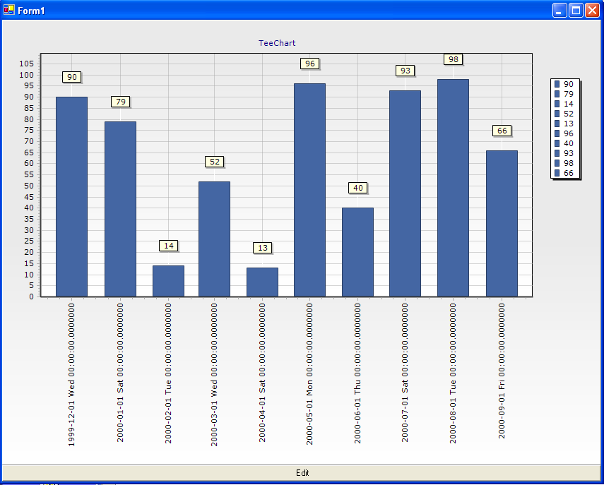

As can be see the monthly labels line up perfectly. However using the following code
      TChart1.Axes.Bottom.Increment = Utils.GetDateTimeStep(DateTimeSteps.OneWeek)
      Dim dte = New DateTime(1999, 12, 26, 0, 0, 0, 0)
         dte = dte.Adddays(7)
      Next
   End Sub
on which the labels do not correctly align
Changing the code to be yearly like this
      TChart1.Clear()
      TChart1.Axes.Bottom.Increment = Utils.GetDateTimeStep(DateTimeSteps.OneYear)
      Dim dte = New DateTime(1999, 12, 30, 0, 0, 0, 0)
         dte = dte.AddYEARS(1)
      Next
   End Sub
again the labels are aligned perfectly, the problem is definately only present with weekly data

A little more information. If the start date of the data to be plotted is not aligned with the interval the labels do not line up properly. For instance changing the monthly code to
TChart1.Clear()
Dim dte = New DateTime(1999, 12, 25, 0, 0, 0, 0)
dte = dte.AddMONTHS(1)
Next
End Sub
produces
where the labels are not aligned.
The examples I've provided Weekly, Monthly or Yearly have each date correcly aligned to the interval, weekly each date is a sunday, monthly each date is the first date of the month and yearly each date is the first date of the year. The missalignment occurs in all intervals when thedate of the first point to be plotted does not line up accordingly except WEEKLY which doesn't align at all.

Some more observations on this one which I think clearly identify the problem.
When plotting monthly data (i.e. increment set to one month and the data points one month apart) the first date shown on the chart is always the 1st day of the month that the first bar date falls in, for instance if the first date in the data is 20th January then the first date shown on the chart will be 1st January with the bar slightly offset (aligning with where the 20th would be).
However for weekly data the first date shown on the chart is always 3 days before the first date in the data, for instance if the first date in the data is the 4th of August then the chart shows 1st of August, if the first date in the data is 20th August then the first date shown on the chart is 17th August, and therefor when plotting weekly data the bars will will NEVER align with the labels as the labels are always a few days before the bars.
Adrian Heald
Director
ITSM Reporting Services Pty Ltd
http://www.reportingservices.com

Captell wrote:This is using version 3.5.3146.24804,for some unknown reason even in this version I'm now getting this misalignment with the weekly chart even when I try it with my application, which wasn't exhibiting the problem a few weeks ago, as can be seen from earlier posts showing weekly charts
Yes, my assertion is that there has never been a difference in functionality in this respect between the latest version and v3.5.3146.24804.
Captell wrote:Some more observations on this one which I think clearly identify the problem.
I've known what the problem is for a while :) . The solution is in the next maintenance release, due out very shortly. The solution is the IncrementOffset property, which in your case will be able to be used like this:
      tChart1.Clear();
      tChart1.Axes.Bottom.IncrementOffset = 4;
      var date = new DateTime(1999, 12, 25, 0, 0, 0, 0);
and the result is this:
Thank you!
