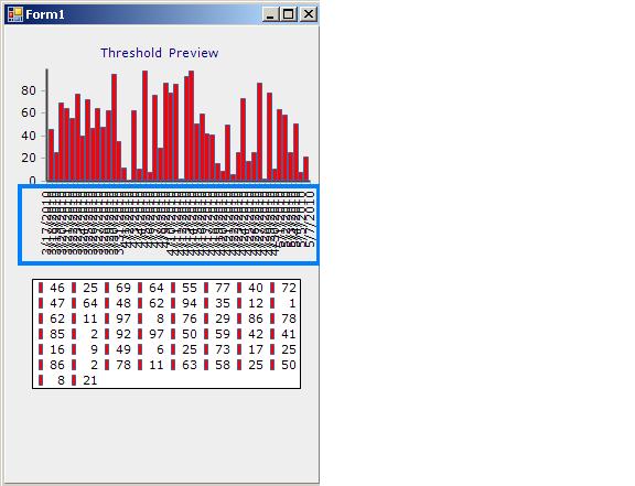

Hi Sandra,
I think you don't understand the problem that I have, since I tried to use the code that you send , and in the both of them have the problems that I already told you.
Example 1 : draw all the dates , but when the window is too small the dates are drown on top of each other.( see I marked it in blue).
Example 2 :The dates look ok, but the first and the last date in the range does not appear all the time . (I marked in blue the missing date)
Ex 2.JPG (89.23 KiB) Viewed 21582 times
I want to marge between them - I want to see clearly the dates as in ex2 , but I want the first and the last label always to be shown.

Hi ,
I tried to use the new example , but I still have the same problem in the range is big.
If I don't try to change the label ,in resizing the tee chart is smart and know how to show part of the labels on redraw and it looks good.
I want the same behavior an on addition always to add the first and the last date in the range.
In all the examples that you send me - you shows custom labels, and when we add the custom labels on resizing there is a problem, the labels are draw on top of each other.
see the attached pic - with last example you send me

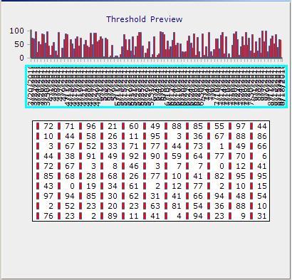

Hi ,
This solution is not good for me , I want the Increment to be one day since when the range is only 3-4 days I want to see all the days.
And when the range of the data is 3-5 months , I want to see the first and the last date and only part of the dates in the middle.
In the solution that you suggest I also have problem on resizing the dialog ( see the images that I already attached in my previous comments).
