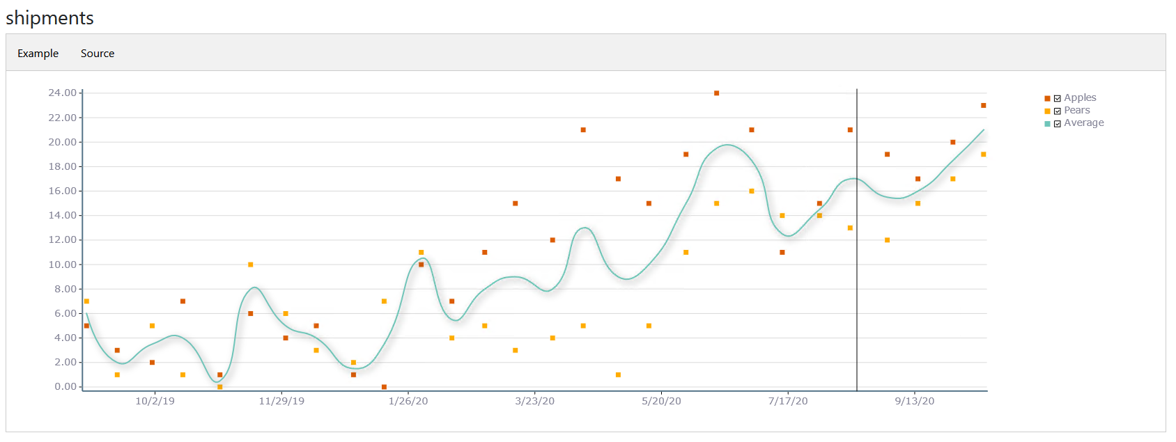

I’m pleased to inform you that your request has been successfully completed and is now ready for implementation. With the latest release (2024.8.30), you can begin using it immediately.
tChart.Legend.ActiveStyle = LegendActiveStyles.CheckBox;
And this is how it looks like:
Best regards,
Edu
