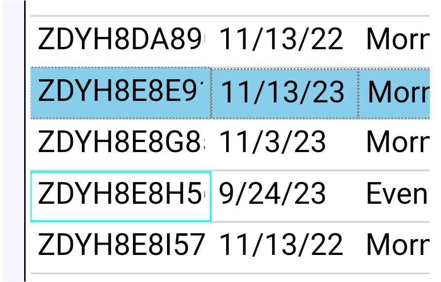

Post by TheOtherPrefontaine » Fri Nov 17, 2023 6:15 am
I've attached a small screen shot.
You can see the selected row, and also a light blue rectangle around the cell I just tapped on. So teegrid knows I tapped there since it painted the light blue rectangle, but its just not moving the selection.
Hope this provides a clue to what's happening. I really need this to work, as users on android will expect a tap to change the selection .
Thanks much!

This is still checking out ok on tests on a mobile device. In this case a Realme 6 on Android 11.
I can make the test project available if you think it may be useful. It runs 10,000 lines and marks the selected row as an arrow at row beginning. I put a label in to confirm the selected row.
It reports badly only for the last row on a visible screen where the row is not complete. In this case it returns a -1.
Using RAD Studio 12 with TeeGrid v1.14.
