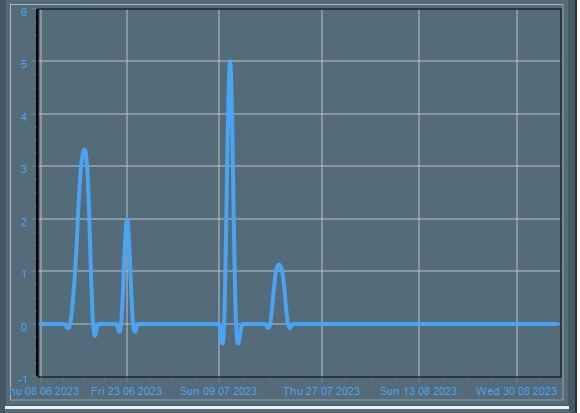

Post by Cortech » Wed Sep 06, 2023 6:24 am
I am facing an issue with the Line chart series of TChart when using the DrawStyle Curve. The line is going below 0, even though none of the values are below zero (please refer to the attached image). I am looking for a solution to prevent the line from dipping below zero and maintain the curve style. Any help would be greatly appreciated, and thank you in advance for your responses.

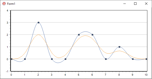

Re: TChart Line Chart Series with DrawStyle Curve Dips Below Zero - How to Fix?
Post by Yeray » Wed Sep 06, 2023 9:41 am
I'd say this is something to expect if you want the curve to pass through the points.
If you don't need the curve to pass though the points, you can use a TSmoothingFunction with Interpolate:=false as follows:

  with TLineSeries(Chart1.AddSeries(TLineSeries)) do
    FunctionType:=TSmoothingFunction.Create(Self);
    with TSmoothingFunction(FunctionType) do
      Interpolate:=False;
      Factor:=6;
    DataSource:=Chart1[0];

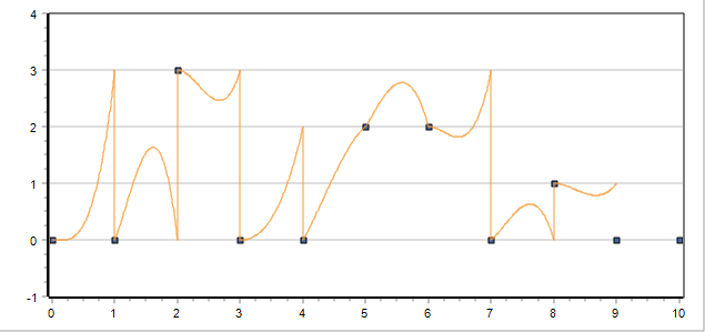

Post by Yeray » Tue Sep 12, 2023 10:22 am
I've tried with a custom cubic spline, but it doesn't give the result I'd expect:

You could try to modify that algorithm or implement your own.
