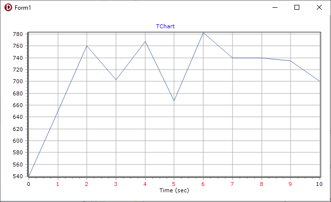

Post by Yeray » Tue Jun 27, 2023 11:44 am
If you want all the labels in the bottom axis to be red you can just set the Bottom axis LabelsFont.Color:
uses Series;
  Chart1.Align:=alClient;
  Chart1.Color:=clWhite;
  Chart1.View3D:=False;
  Chart1.Legend.Hide;
  Chart1.AddSeries(TFastLineSeries).FillSampleValues(10);
  Chart1.Axes.Bottom.Title.Text:='Time (sec)';
  Chart1.Axes.Bottom.LabelsFont.Color:=clRed;
If you want only some labels in the bottom axis to be red, you have two options:
You can use the OnDrawLabel event to change the Bottom axis LabelsFont.Color accordingly:
uses Series;
  Chart1.Legend.Hide;
  Chart1.AddSeries(TFastLineSeries).FillSampleValues(11);
  Chart1.Axes.Bottom.OnDrawLabel:=BottomAxisDrawLabel
procedure TForm1.BottomAxisDrawLabel(Sender:TChartAxis; var X,Y,Z:Integer; var Text:String; var DrawLabel:Boolean);
  if (Text<>'0') and (Text<>'10') then
     Sender.LabelsFont.Color:=clRed
     Sender.LabelsFont.Color:=clBlack;
Or you can use custom labels to achieve the same fine control and the same result. Ie:
uses Series;
var i: Integer;
  Chart1.Legend.Hide;
  Chart1.Draw;
  with Chart1.Axes.Bottom do
    Items.Automatic:=False;
    for i:=0 to Items.Count-1 do
      if (Items[i].Text<>'0') and (Items[i].Text<>'10') then
         Items[i].Format.Font.Color:=clRed;

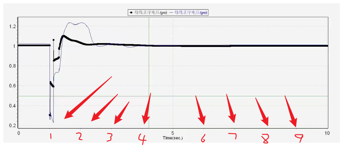

You misunderstood!!!
What I mean is that the X-axis now only displays 1, 5, and 10. How to make the X-axis display 1, 2, 3, 4, 5, 6, 7, 8, 9, 10
That is to say, how to make the X-axis display more value text

By default, the Axis Increment is set to 0 which automatically tries to fit as many labels as possible.
Did you change this setting?
You can change it again:
Chart1.Axes.Bottom.Increment:=0;
Or, if you want to force those labels, you can set it to 1:
Chart1.Axes.Bottom.Increment:=1;

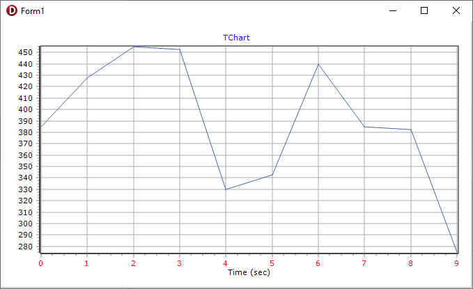

Post by » Thu Jun 29, 2023 2:17 am
[img]C://Users//ly//Desktop//333.png[/img]
This effect is not very good, it should be more. Can you modify your implementation process???

If you want labels at 0, 1, 2,..., and you want to force it so labels 0.5, 1, 1.5,... don't appear when zooming, you can set Increment:=1.

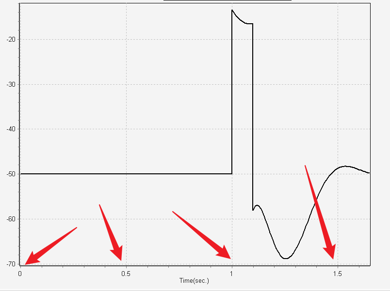

It's not necessary to have an interval of 1. What I mean is whether it's possible to display as many numbers as possible during adaptation?
Posts: 9715
Re: How to display red numbers on the X-axis
Post by Yeray » Mon Jul 03, 2023 5:59 am
Try setting an Increment of 0.5, or to the minimum increment you want to support in your app.
