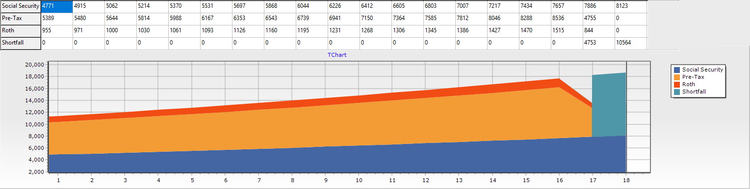

I've spent hours working on this and getting it working, only to find another where it doesn't work.
In the attached demo, a chart is created with area series that should step down to zero when the next value is zero or from zero when the previous value was zero. I can get it working some of the time, but I can't get it working for all four options.
In the demo, there are two methods for creating the char: UpdateChart1 and UpdateChart2, Clicking on the "Illustration #..." radio button produces different results. The combo box on the top right selects which chart method is used. UpdateChart1 shows the chart correctly but doesn't do the stepping. UpdateChart2 has different problems, depending upon which illustration is selected. (The chart is supposed to have a smooth upper line, showing income in retirement).
How can I achieve this?

Re: Stepping as stacked area series to/from zero values
Could you please draw what's the result you'd like to obtain? I'm not sure to understand it.
I see inTest Always #? wrote: ↑Mon Mar 20, 2023 8:34 pmUpdateChart2 has different problems, depending upon which illustration is selected. (The chart is supposed to have a smooth upper line, showing income in retirement).
UpdateChart2
you are adding zeros to draw stairs/steps (instead of slopes) when going from/to a zero. But I'm not sure to see what's wrong with that approach.Best Regards,

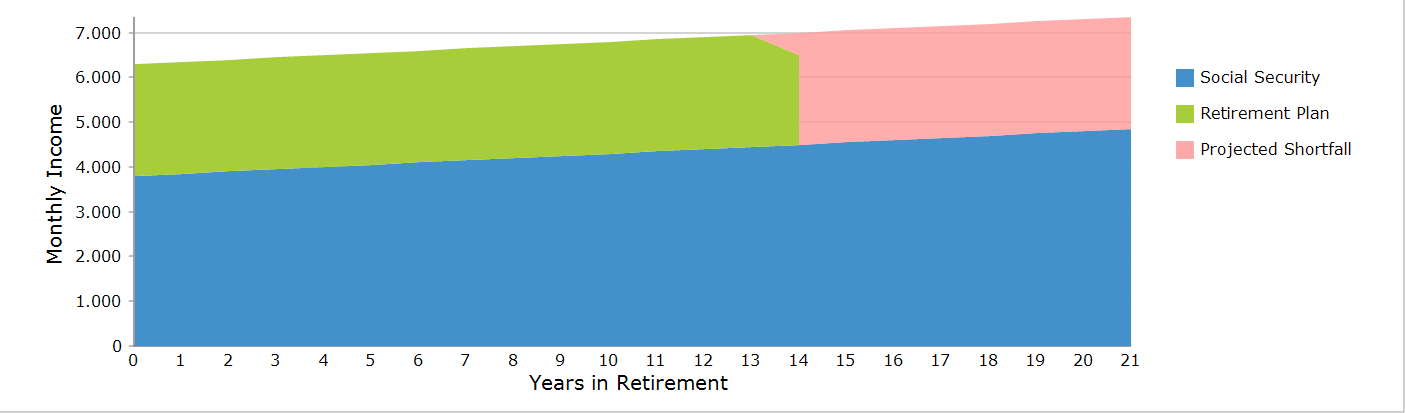

I made a simple example trying to replicate the image you posted above.
Here the result: And the code to make it:
I haven't tried that data with the code in your "method 2", but the idea is very similar. Doesn't it work for you?

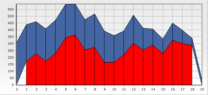

That will work for this chart, but I need a solution that works for various scenarios when I don't know the data.
Could you please draw what would you'd like to obtain in those situations where you are failing to obtain it?
You sent us a great project to test with 4 data scenarios. That's fantastic but I'm not sure to understand what's the goal in each of those scenarios.

They should produce stepped area charts. In all the cases in the demo, the top line should be steady/slowly increasing (like the image provided earlier).
Does that make sense?
