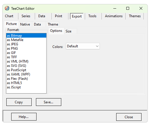

Do you also plan on releasing the source code as well? Because we need to add some custom behavior on the Export button click, we have to build from the source code. Is there somewhere I can submit a feature request IRT hooking into this button's click event?
Much appreciated.
Kris
Re: Zoom Issue (regression)
Post by Christopher » Wed Apr 12, 2023 8:43 am
Hello Kris,
Kris C wrote:
Tue Apr 11, 2023 6:12 pm
Yes, we will also release a new sourcecode version as well.
However, I think it would be more convenient for you if you could hook your code into all our NuGet releases too. If you could please give me an idea of what you need to do in the 'Save...' button code (the button being the 'Save...' button here)
Screenshot from 2023-04-12 10-40-47.png (18 KiB) Viewed 12427 times
Then I can hook up a delegate or whatever to pass in the variables to modify whatever it is you need to modify, e.g.
            void DoSomething(Tuple<double, int> myParams)
            var editor = new Editor(tChart1);
            editor.OnExportSaveDel = DoSomething;
            editor.ShowModal();
