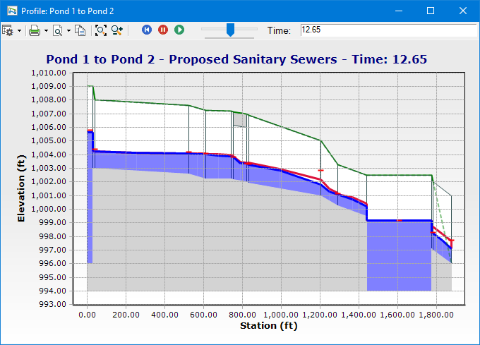

The first image is from our current release that uses v2009:
Graph before upgrading to v2022

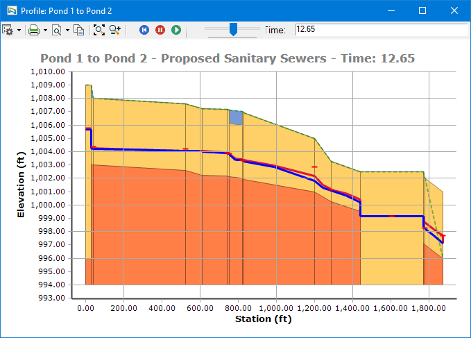

This is the same graph after upgrading to TeeChart v2022:
Graph after upgrading to v2022
If the colors were simply a variation on the shade of grey, that would be one thing. But to go from grey to orange is something completely different. I checked our code and we are using Color.LightGrey. How does that translate into orange by anyone’s imagination?

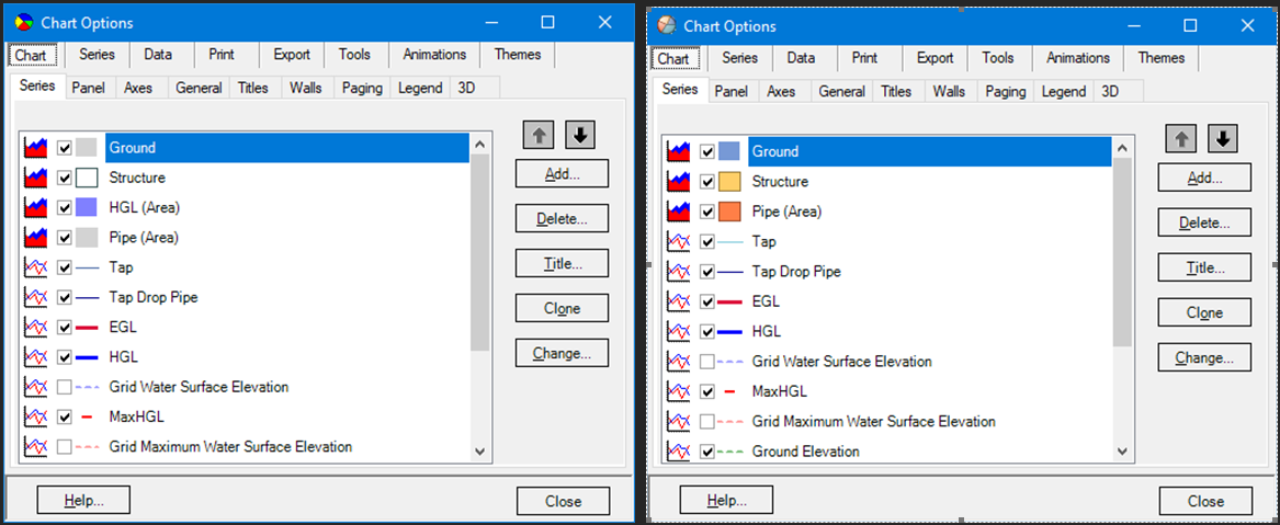

Here are the graph options. Left is pre-upgrade and right is post-upgrade:
Graph Options - Pre and Post Upgrade
In the options on the right there is a series missing (HGL (Area)) and the colors are wrong.

I would imagine that if you didn't specify series colours in your code, e.g.
tChart1[0].Color = Color.Red;
then the colours are being read from the default theme, which has been changed over the years. Are you specifying series colours in your code?

Yes. I have verified and debugged the code that assigns the colors for the series. They are 100% definitely being set.
I too have determined that the theme is at play here. I just don't know how to override it. At some point the theme overrides the colors assigned to the series.
The new theme I believe is Lookout. The old them seems to be Opera. I've tried setting the default theme in the TeeChart source to be Opera but that doesn't seem to make a difference (though I'm hoping for a solution that doesn't require modifying the source).

I dug into this some more and found several series where we were not assigning the Color property of the series but only the color of the brush or pen. This worked in v2009 so it must have been a bug that we inadvertently took advantage of. Once i assigned colors to these series in the graph, then the theme colors no longer got applied.
There is one last issue that needs to be fixed. If you look at the "Before upgrade" image in my original post, the area up and to the right above the [green] series is a grey color. For the life of me, I cannot figure out what this property is. I can't seem to find it in the chart options dialog, either.
I plan to give a demo showing the use of the upgraded TeeChart next week and if I leave that area white, I am going to be asked about it (that's how detailed my team is). So, is there a way to get that white to turn back to grey? If there is not, then that is what I will report but I need to ask the question.
