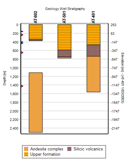

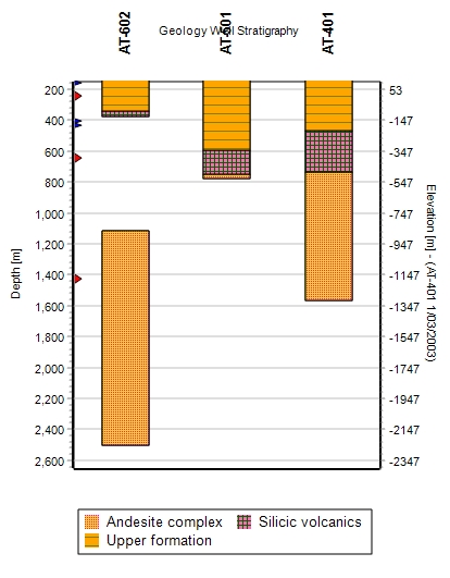

In my previous topic, I was asking about the correct horizontal placement of a title above a self-stacked bar chart. In this post, I would like to be able to set the vertical position of the title just above the top axis of the bar chart, and have it remain there on scroll or zoom operations. As shown in the attached images, the title scrolls off the top of the chart at present if I use CalcBarBounds, or disappear entirely if I zoom the chart.
Any suggestions much appreciated.

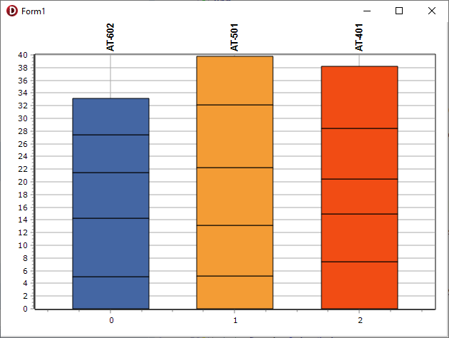

Taking the code from the reply I just wrote there, I've modified it to also calculate the value for the TAnnotationTool.Top property to position them just above the ChartRect:

    annot.Top := Chart1.ChartRect.Top - LAcross - 10;
