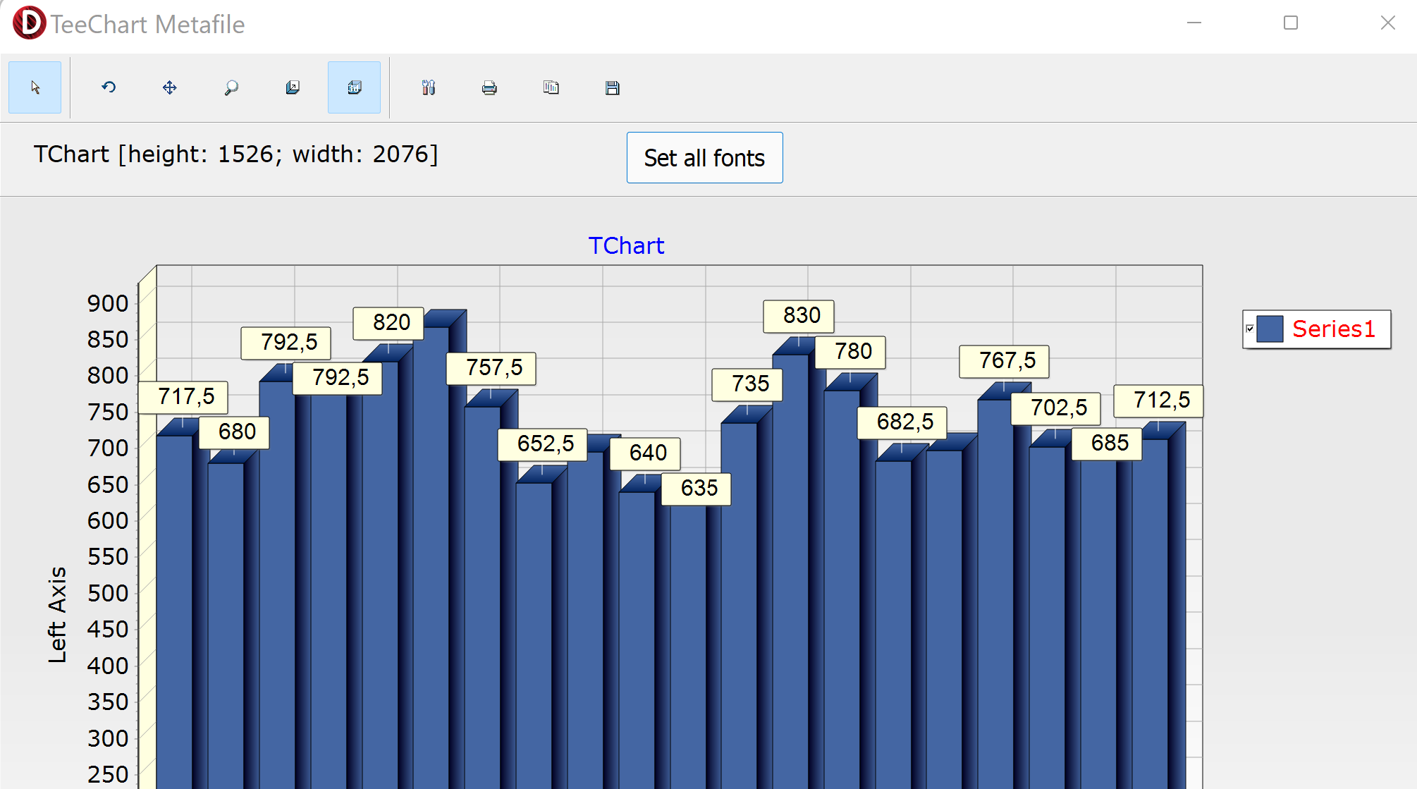

Here is the DisplaySize example with a checkbox in the legend. The snapshot is taken from a 300% scaling on a high DPI monitor.
As you can see the checkbox is far from usable. Also the icons in the bar get unreadable. The images do not properly scale.
In a setup with 2 screens with different resolutions the program should be aware about the change of scaling and/or resolution (shift of GUI between monitors). Therefore the program or here better chart must get information about a change.
Possible you do this by the ChangeScale procedure as mentioned in https://www.steema.com/support/viewtopi ... 188#p78188
But by the DisplaySize example the setting of the font sizes is just by a button click and not an automatic reaction on a screen scaling.
And as the example shows the checkboxes are not touched in any way.

The "Set all fonts" button in the DisplaySize example was an attempt to find a workaround when I wasn't able to find a proper ChangeScale implementation. However, that last code should work fine when moving a chart between screens with different scales.
I'll revise the legend checkbox and the commander icons. Doesn't the rest of the chart adapt correctly to the scale changes for you with that ChangeScale implementation?

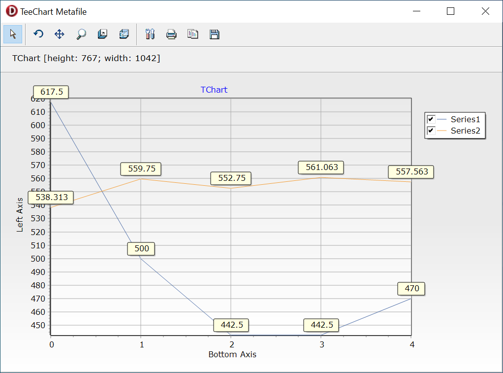

A simple line series with pen width = 1 gets very thin on a high DPI monitor. So actually I try to help myself by Pen.Width := nominal_pen_width * Screen.PixelsPerInch / 96 as a quick turnaround.
It doesn't look bad for me at 150%:
But you could try to override the ChangeScale method and change the series pen width there.
