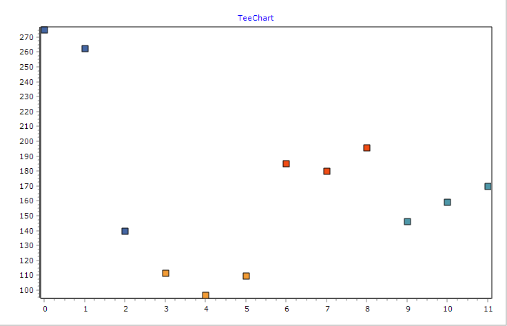

Re: Hiding Points in a Series
Post by Yeray » Fri Nov 12, 2021 10:23 am
Hello Save,
Yes, you can hide specific points by setting them as "null points". Ie:
Private Sub Form_Load()
  With TChart1
    .Aspect.View3D = False
    .Legend.Visible = False
    .Panel.Gradient.Visible = False
    .Panel.Color = vbWhite
    .Walls.Back.Gradient.Visible = False
    .Walls.Back.Color = vbWhite
    .Axis.Left.GridPen.Visible = False
    .Axis.Bottom.GridPen.Visible = False
    Dim i, j As Integer
    For i = 0 To 3
      .AddSeries scPoint
      .Series(i).FillSampleValues 12
      For j = 0 To .Series(i).Count - 1
        If (j < i * 3) Or (j >= (i + 1) * 3) Then
          .Series(i).SetNull j
        End If
      Next j
    Next i
  End With

Post by DLauben » Sat Nov 13, 2021 2:11 am
Thank you Yeray. That worked perfectly. Much appreciate -- both your explanation and timely reply.
I now know to look at the .SetNull functionality. Before your reply, I was thinking it would be something like a 'hidden' attribute, but now I now that wasn't the way to go.
