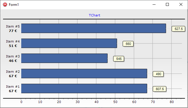

I have a horizontal bar series in a chart. A customer wants the axis line on the bottom of the chart to extend farther left, and one at the top that matches. See here:
I put arrows showing the lines.
Is something like this possible? (I have attached a demo--if it can be done, do you mind updating the demo).
Much appreciated.

Post by Yeray » Tue Apr 14, 2020 8:15 am
Here with a margin of 10 pixels each side:

Thank you. That works perfect for the TChart, but when I create an image of the chart with a different width, the lines are not the correct width. See the attached demo--the red lines are painted in the AfterDraw event and are not the correct width.

Post by Marc » Wed Apr 22, 2020 5:49 pm
This is an option:
Add two new variables in the var declarations of the Form:
var
  Form1: TForm1;
  aWidth, chartWidth : Integer; ///<-- these
In FormCreate initialise the variables:
var
  I: Integer;
  lValue: Double;
  aWidth:=Chart1.Width;  //<-- here
  chartWidth:=aWidth;  //<-- and here
  Series1.Clear;
In the AssignChartToGraphic method add in a set for aWidth:
  lCanvasClass := TCanvas3DClass(aChart.Canvas.ClassType);
  if lCanvasClass <> TTeeCanvas3D then
    aChart.Canvas := TTeeCanvas3D.Create;
  aWidth:=aRect.Right;  //<--- here
  lHoldGradientVisible := aChart.Gradient.Visible;
In the OnAfterDraw event add in the variable width size and reset the variable.
ie.
  with Chart1.Canvas do begin
    Pen.Color := clRed;
    Pen.Width := Chart1.BottomAxis.Axis.Width;
    HorizLine3D(10,aWidth-10,Chart1.ChartRect.Top,0);
    HorizLine3D(10,aWidth-10,Chart1.Axes.Bottom.PosAxis+1,0);
    aWidth:=chartWidth; //reset
Unit attached.
