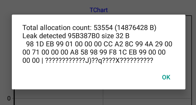

As far as I can see, I can't get much further with LeakCheck. I get this:
And this:

05-14 14:17:08.094 22707 22707 W leak    :   F8 79 F1 D5 02 00 00 00 AA 9C 08 D6 75 00 00 00 B0 C2 D1 D6 B0 47 F2 D4 00 00 00 00 00 00 00 00 | ?y??????????u????????G??????????
05-14 14:17:08.096 22707 22707 W leak    :   B9 9C 08 D6 38 9B 50 D4 90 07 08 D6 13 00 00 00 01 00 00 00 | ????8?P?????????????
05-14 14:17:08.097 22707 22707 W leak    : Leak detected D4509B30 size 16 B

05-14 14:17:08.218 22707 22707 W leak    : Leak detected D45110B0 size 44 B
05-14 14:17:08.219 22707 22707 W leak    :   CC 78 F1 D5 02 00 00 00 61 18 FA D5 15 00 00 00 B0 C2 D1 D6 B0 06 51 D4 00 00 00 00 3C 13 51 D4 | ?x??????a?????????????Q?????<?Q?
05-14 14:17:08.220 22707 22707 W leak    :   08 00 00 00 80 17 FA D5 00 00 00 00 | ????????????
05-14 14:17:08.222 22707 22707 W leak    : Leak detected D4511330 size 28 B for UnicodeString {RefCount: 1} = another
05-14 14:17:08.223 22707 22707 W leak    : Leak detected D45115B0 size 52 B
05-14 14:17:08.224 22707 22707 W leak    :   F8 79 F1 D5 02 00 00 00 84 18 FA D5 31 00 00 00 B0 C2 D1 D6 B0 F5 5F D4 00 00 00 00 00 00 00 00 | ?y??????????1?????????_?????????
05-14 14:17:08.225 22707 22707 W leak    :   92 18 FA D5 00 00 00 00 3A 72 EC D5 10 00 00 00 01 00 00 00 | ????????:r??????????
05-14 14:17:08.227 22707 22707 W leak    : Leak detected D4510BB0 size 44 B
05-14 14:17:08.228 22707 22707 W leak    :   CC 78 F1 D5 01 00 00 00 95 18 FA D5 12 00 00 00 B0 C2 D1 D6 B0 15 51 D4 00 00 00 00 BC 1A 51 D4 | ?x????????????????????Q???????Q?
05-14 14:17:08.229 22707 22707 W leak    :   08 00 00 00 80 17 FA D5 00 00 00 00 | ????????????
05-14 14:17:08.230 22707 22707 W leak    : Leak detected D4511AB0 size 22 B for UnicodeString {RefCount: 1} = Self
05-14 14:17:08.232 22707 22707 W leak    : Leak detected D4511D30 size 52 B
05-14 14:17:08.233 22707 22707 W leak    :   F8 79 F1 D5 02 00 00 00 B5 18 FA D5 2A 00 00 00 B0 C2 D1 D6 B0 F5 5F D4 00 00 00 00 00 00 00 00 | ?y??????????*?????????_?????????
05-14 14:17:08.234 22707 22707 W leak    :   BC 18 FA D5 00 00 00 00 3A 72 EC D5 11 00 00 00 01 00 00 00 | ????????:r??????????
05-14 14:17:08.236 22707 22707 W leak    : Leak detected D4511830 size 44 B
05-14 14:17:08.237 22707 22707 W leak    :   CC 78 F1 D5 01 00 00 00 BF 18 FA D5 12 00 00 00 B0 C2 D1 D6 30 1D 51 D4 00 00 00 00 3C 22 51 D4 | ?x??????????????????0?Q?????<"Q?
05-14 14:17:08.239 22707 22707 W leak    :   08 00 00 00 80 17 FA D5 00 00 00 00 | ????????????
05-14 14:17:08.240 22707 22707 W leak    : Leak detected D4512230 size 22 B for UnicodeString {RefCount: 1} = Self
05-14 14:17:08.241 22707 22707 W leak    : Leak detected D45124B0 size 52 B
05-14 14:17:08.243 22707 22707 W leak    :   F8 79 F1 D5 02 00 00 00 DF 18 FA D5 24 00 00 00 B0 C2 D1 D6 B0 F5 5F D4 00 00 00 00 00 00 00 00 | ?y??????????$?????????_?????????
05-14 14:17:08.244 22707 22707 W leak    :   EC 18 FA D5 00 00 00 00 00 00 00 00 12 00 00 00 01 00 00 00 | ????????????????????
05-14 14:17:08.245 22707 22707 W leak    : Leak detected D4511FB0 size 44 B
05-14 14:17:08.246 22707 22707 W leak    :   CC 78 F1 D5 01 00 00 00 EF 18 FA D5 12 00 00 00 B0 C2 D1 D6 B0 24 51 D4 00 00 00 00 BC 29 51 D4 | ?x???????????????????$Q??????)Q?
05-14 14:17:08.248 22707 22707 W leak    :   08 00 00 00 80 17 FA D5 00 00 00 00 | ????????????
05-14 14:17:08.249 22707 22707 W leak    : Leak detected D45129B0 size 22 B for UnicodeString {RefCount: 1} = Self
05-14 14:17:08.250 22707 22707 W leak    : Leak detected D4512C30 size 52 B
05-14 14:17:08.251 22707 22707 W leak    :   F8 79 F1 D5 02 00 00 00 03 19 FA D5 3D 00 00 00 B0 C2 D1 D6 B0 F5 5F D4 00 00 00 00 00 00 00 00 | ?y??????????=?????????_?????????
05-14 14:17:08.252 22707 22707 W leak    :   0A 19 FA D5 38 27 51 D4 3A 72 EC D5 13 00 00 00 01 00 00 00 | ????8'Q?:r??????????
05-14 14:17:08.254 22707 22707 W leak    : Leak detected D4512730 size 12 B
05-14 14:17:08.255 22707 22707 W leak    :   01 00 00 00 01 00 00 00 30 36 51 D4 | ????????06Q?
05-14 14:17:08.256 22707 22707 W leak    : Leak detected D4512EB0 size 44 B
05-14 14:17:08.258 22707 22707 W leak    :   CC 78 F1 D5 01 00 00 00 0D 19 FA D5 12 00 00 00 B0 C2 D1 D6 30 2C 51 D4 00 00 00 00 BC 33 51 D4 | ?x??????????????????0,Q??????3Q?
05-14 14:17:08.259 22707 22707 W leak    :   08 00 00 00 80 17 FA D5 00 00 00 00 | ????????????
05-14 14:17:08.260 22707 22707 W leak    : Leak detected D45133B0 size 22 B for UnicodeString {RefCount: 1} = Self
05-14 14:17:08.261 22707 22707 W leak    : Leak detected D4513630 size 44 B
05-14 14:17:08.262 22707 22707 W leak    :   CC 78 F1 D5 02 00 00 00 1F 19 FA D5 13 00 00 00 B0 C2 D1 D6 30 2C 51 D4 00 00 00 00 BC 38 51 D4 | ?x??????????????????0,Q??????8Q?
05-14 14:17:08.263 22707 22707 W leak    :   08 00 00 00 94 CD F9 D5 00 00 00 00 | ????????????
05-14 14:17:08.265 22707 22707 W leak    : Leak detected D45138B0 size 20 B for UnicodeString {RefCount: 1} = obj
05-14 14:17:08.266 22707 22707 W leak    : Leak detected D4513B30 size 52 B
05-14 14:17:08.267 22707 22707 W leak    :   F8 79 F1 D5 02 00 00 00 40 19 FA D5 2A 00 00 00 B0 C2 D1 D6 B0 F5 5F D4 00 00 00 00 00 00 00 00 | ?y??????@???*?????????_?????????
05-14 14:17:08.268 22707 22707 W leak    :   47 19 FA D5 00 00 00 00 3A 72 EC D5 14 00 00 00 01 00 00 00 | G???????:r??????????
05-14 14:17:08.269 22707 22707 W leak    : Leak detected D4513130 size 44 B
05-14 14:17:08.271 22707 22707 W leak    :   CC 78 F1 D5 01 00 00 00 4A 19 FA D5 12 00 00 00 B0 C2 D1 D6 30 3B 51 D4 00 00 00 00 3C 40 51 D4 | ?x??????J???????????0;Q?????<@Q?
05-14 14:17:08.272 22707 22707 W leak    :   08 00 00 00 80 17 FA D5 00 00 00 00 | ????????????
05-14 14:17:08.273 22707 22707 W leak    : Leak detected D4514030 size 22 B for UnicodeString {RefCount: 1} = Self
05-14 14:17:08.275 22707 22707 W leak    : Leak detected D45142B0 size 52 B
05-14 14:17:08.276 22707 22707 W leak    :   F8 79 F1 D5 02 00 00 00 6A 19 FA D5 31 00 00 00 B0 C2 D1 D6 B0 F5 5F D4 00 00 00 00 00 00 00 00 | ?y??????j???1?????????_?????????
05-14 14:17:08.277 22707 22707 W leak    :   7A 19 FA D5 00 00 00 00 84 17 FA D5 15 00 00 00 01 00 00 00 | z???????????????????
05-14 14:17:08.278 22707 22707 W leak    : Leak detected D4513DB0 size 44 B
05-14 14:17:08.279 22707 22707 W leak    :   CC 78 F1 D5 01 00 00 00 7D 19 FA D5 12 00 00 00 B0 C2 D1 D6 B0 42 51 D4 00 00 00 00 BC 47 51 D4 | ?x??????}????????????BQ??????GQ?
05-14 14:17:08.281 22707 22707 W leak    :   08 00 00 00 80 17 FA D5 00 00 00 00 | ????????????
05-14 14:17:08.282 22707 22707 W leak    : Leak detected D45147B0 size 22 B for UnicodeString {RefCount: 1} = Self
05-14 14:17:08.283 22707 22707 W leak    : Leak detected D4514A30 size 52 B
05-14 14:17:08.284 22707 22707 W leak    :   F8 79 F1 D5 02 00 00 00 9B 19 FA D5 33 00 00 00 B0 C2 D1 D6 B0 F5 5F D4 00 00 00 00 00 00 00 00 | ?y??????????3?????????_?????????
