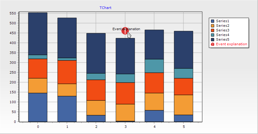

But, if you want to show the icon in the legend you should use an extra series, ie an TImagePointSeries, and then you can use it to draw the icon and text on the chart. Ie:
uses VCLTee.Series, VCLTee.TeePng, VCLTee.ImaPoint;
var hitIcon: TImagePointSeries;
procedure TForm1.Chart1MouseMove(Sender: TObject; Shift: TShiftState; X,
  Y: Integer);
   hitIcon.Marks.Visible:=hitIcon.Clicked(X,Y)>-1;
var i: Integer;
    tmp: Double;
  Chart1.View3D:=False;
  for i:=0 to 4 do
      FillSampleValues;
      MultiBar:=mbStacked;
      Marks.Visible:=False;
  hitIcon:=Chart1.AddSeries(TImagePointSeries) as TImagePointSeries;
  with hitIcon do
    Title:='Event explanation';
    Pointer.Size:=24;
    Pointer.Picture.LoadFromFile('C:\tmp\exclamation_icon.png');
    Pointer.InflateMargins:=False;
    tmp:=0;
      if Chart1[i] is TBarSeries then
         tmp:=tmp+Chart1[i].YValue[3];
    Chart1.Draw;
    with Chart1.Axes.Left do
      tmp:=CalcPosPoint(CalcPosValue(tmp) - Pointer.Size);
    AddXY(3, tmp, Title);
    Marks.Transparent:=True;
  Chart1.Axes.Bottom.LabelStyle:=talValue;

Thank you for this. I played with it a little bit and like the solution--but sometimes the icon is cut off of the chart:
You can reproduce this in the attached demo (simply put the icon on the tallest stack).
Is there a way to fix this? It would be nice if there wasn't unnecessary margin? created.

You can set a MaximumOffset to the left axis, ie after setting the InflateMargins to false (line 117):
      GetVertAxis.MaximumOffset:=Pointer.VertSize;

That is pretty slick. I don't understand it but it works.
Thank you
