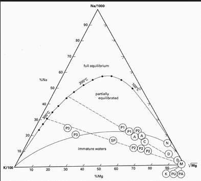

I am trying to create some standard geothermal ternary plots and having difficulty with some aspects. The plot I am trying to emulate is shown here. . I have also attached a test program which includes a typical data set, consisting of three numerical values, X, Y and Z, a Sample Site name and a Sample Date. I have the following questions:
1. Can I write the Sample Site on the chart besides each point, and if so how?
2. Can I write the Sample Site in the legend, and the Sample Date beside each point (or vice versa)?
3. Can I make the legend box wider to automatically fit the legend (it is not wide enoungh when the Sample Site and date are concatenated).
4. Are there tools to draw the two curved lines and text (names of regions and temperatures on the upper curved line) on the graph as in the attached image?
5. Does TeeChart provide tools to draw lines of best fit for selected points?
6. Finally, is it possible to write the square root symbol by code in TeeChart?
I look forward to any suggestions you can offer.
Thanks and regards
Errol

I'm afraid the functions in TeeChart only support the regular perpendicular axes. These lines should be calculated and drawn manually at OnAfterDraw event. If you tell us what functions you'd like to use, we can think on the best way to use them.
As above, the Trend and the Exponential Trend functions sound as what you'd like to use but they are thought to be linked to a Line series, which uses perpendicular axes. However, you could try to inherit TLineSeries to use the axes in the Ternary plot. I haven't tried that.
