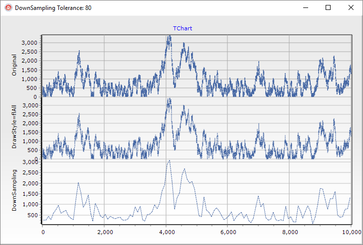

There is also the option to draw the line/fastline series as a polyline. This can be done setting the DrawStyle property to flAll (flSegments is the default). However, as you can see in this simple example doesn't solve the problem:
The problem is when you have points so close that there isn't space between them to draw a line and a leave a white space (to have a dash). The only way around I can think on is by reducing the number of points... and thus loosing some precision.
uses Series, TeeDownSampling;
var dFunc: TDownSamplingFunction;
dSeries: TFastLineSeries;
var i: Integer;
Chart1.Legend.Hide;
Chart1.View3D:=False;
Chart1.Hover.Visible:=False;
Chart1.Axes.Left.EndPosition:=33;
Chart1.Axes.Left.Title.Caption:='Original';
with Chart1.CustomAxes.Add do
StartPosition:=33;
EndPosition:=66;
LabelsFont.Assign(Chart1.Axes.Left.LabelsFont);
Title.Font.Assign(Chart1.Axes.Left.Title.Font);
Title.Caption:='DrawStyle=flAll';
StartPosition:=66;
Title.Caption:='DownSampling';
for i:=0 to 2 do
with Chart1.AddSeries(TFastLineSeries) as TFastLineSeries do
if i=0 then
FillSampleValues(10000)
DataSource:=Chart1[0];
CustomVertAxis:=Chart1.CustomAxes[i-1];
Color:=Chart1[0].Color;
if i=1 then
DrawStyle:=flAll
else if i=2 then
dSeries:=Chart1[i] as TFastLineSeries;
dFunc:=TDownSamplingFunction.Create(Self);
dFunc.DownSampleMethod:=dsAverage;
dSeries.SetFunction(dFunc);
Pen.Style:=psDash;
CalcTolerance;
procedure TForm1.CalcTolerance;
dFunc.Tolerance:=1;
Chart1.Draw;
if dSeries.Count>0 then
while (Chart1.ChartRect.Right-Chart1.ChartRect.Left) div (dSeries.LastDisplayedIndex-dSeries.FirstDisplayedIndex) < 5 do
dFunc.Tolerance:=dFunc.Tolerance+1;
dSeries.CalcFirstLastVisibleIndex;
Caption:='DownSampling Tolerance: ' + FormatFloat('#,##0', dFunc.Tolerance);

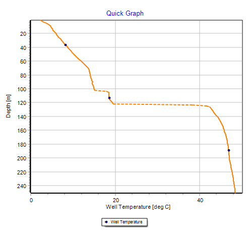

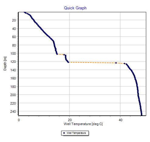

Good afternoon
I seem to have solved the problem of displaying dashed line with data-dense series, and that is to use a Line Series rather than a Fast Line Series, and to set DrawStyles to dsAll and Pointer.Visible to False. See attached DashedLines example program. I then use a Point series to draw points at a user-defined density.
I am surprised that a line series has the capability of displaying dashed lines independent of the data density, whereas a Fast Line Series cannot do this. Intuitively, I would have expected the opposite to be true, but I appreciate there is a solution.
My (hopefully final) question is this. Will the chart drawing be significantly slower using Line Series rather than Fast line Series, assuming say 10 series on a graph each with 10,000 data points (but perhaps only 10 points/symbols drawn per series)?
I look forward to your comments.

I believe you missed to include the .pas.
I've done some tests with this simple example and the application needs about 122ms to repaint using TLineSeries vs about 78ms using TFastLineSeries:

Hi Yeray
Thanks for the tests. I think I can live with the slower paint time. Such big data sets are reasonably rare. I have attached the Dashed Lines project, this time with the missing .pas file, just in case anyone wants to review it.
