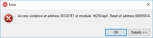

I have since moved to Tokyo, update 3 and purchased the Pro version. But every time I try to add to change things in the Chart Editor, Delphi seems to crash with the attached error.

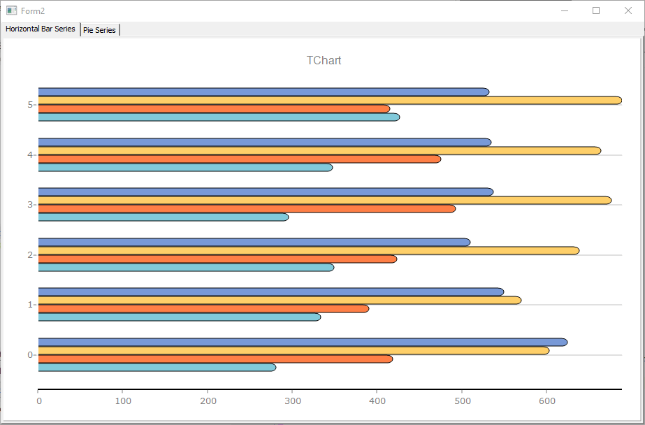

I've cleaned the project a little bit and added several bar series to it.
AnimationCharts.zip
(2.15 KiB) Downloaded 2098 times
See how it moves in this gif:

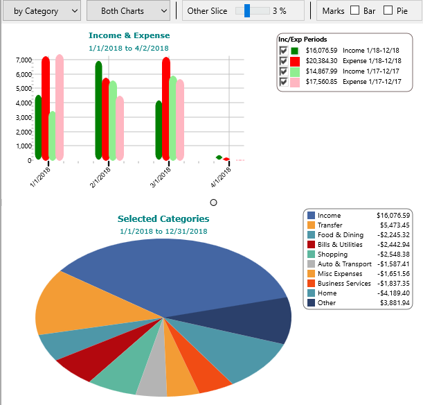

1. Can you tell me what controls the spacing between the bars? As you can see from this image, the bars kinda overlap. I would like them to be evenly spaced and not overlapping.
2. After I drill down to a small pie slice, the bar char is hardly noticeable. How do I adjust the chart so the Bar height is recognizable? In other words, how do I lower the grid to match the bar size so when I drill down, it will fill the bar chart.
3. How can I tell which bars are checked?

realsol wrote:1. Can you tell me what controls the spacing between the bars? As you can see from this image, the bars kinda overlap. I would like them to be evenly spaced and not overlapping.

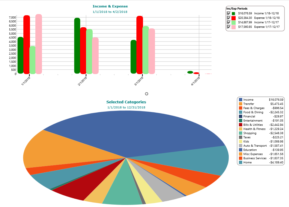

1. This first one shows a bar graph representing all income and expense category totals by month.

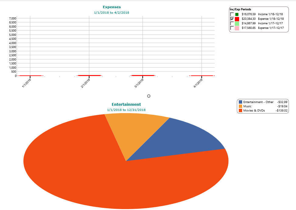

2. The second chart represents the result after a user clicks on the shopping category slice
I would like to redraw the grid to match the highest bar like on the first chart. For the user, it is hard to tell the shopping totals which such $7000 grid.
After user clicks on the 'Shopping' slice
All Bars and full pie
Re: TeeChart Animation
Post by Yeray » Thu Apr 12, 2018 6:53 am
The exact place and exact values depend on the exact code in your project, but you probably have to call SetMinMax(min, max) on the Left axis to set the axis scale that better fits the data to show.
