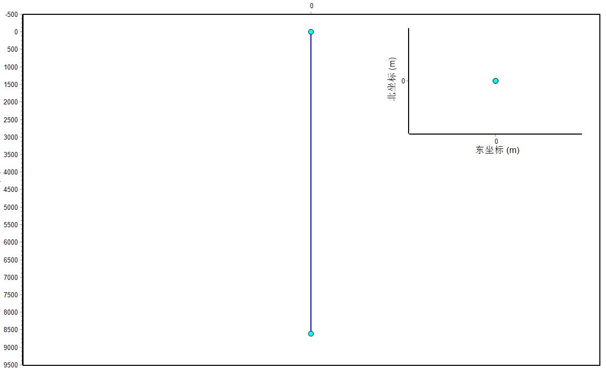

In a Chart, I want to draw curves on two areas (Main Chart and Sub Chart), respectively, and the Sub Chart locates at the Top-Right corner of the Main Chart. I draw the curves on the Main Chart based on the top and left Axes, and the curves on the Sub Chart based on the Custom Axes.
The Scale and Increment of Custom Horizontal Axis are the same with those of the Top Axis, and The Scale and Increment of Custom Vertical Axis are the same with those of the Left Axis. After the curves on the Main Chart are drawn, I should be able to calculate the Height and Width of the Sub Chart according to the Main Chart.

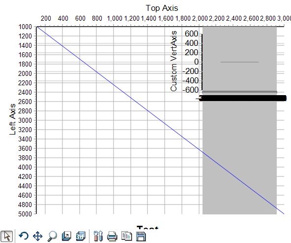

I've added a line of code to clear the series added at design time in your project because they were interfering with the example:
  with TheChart do
      SeriesList.Clear; // Line added
Now the example gives me this result:

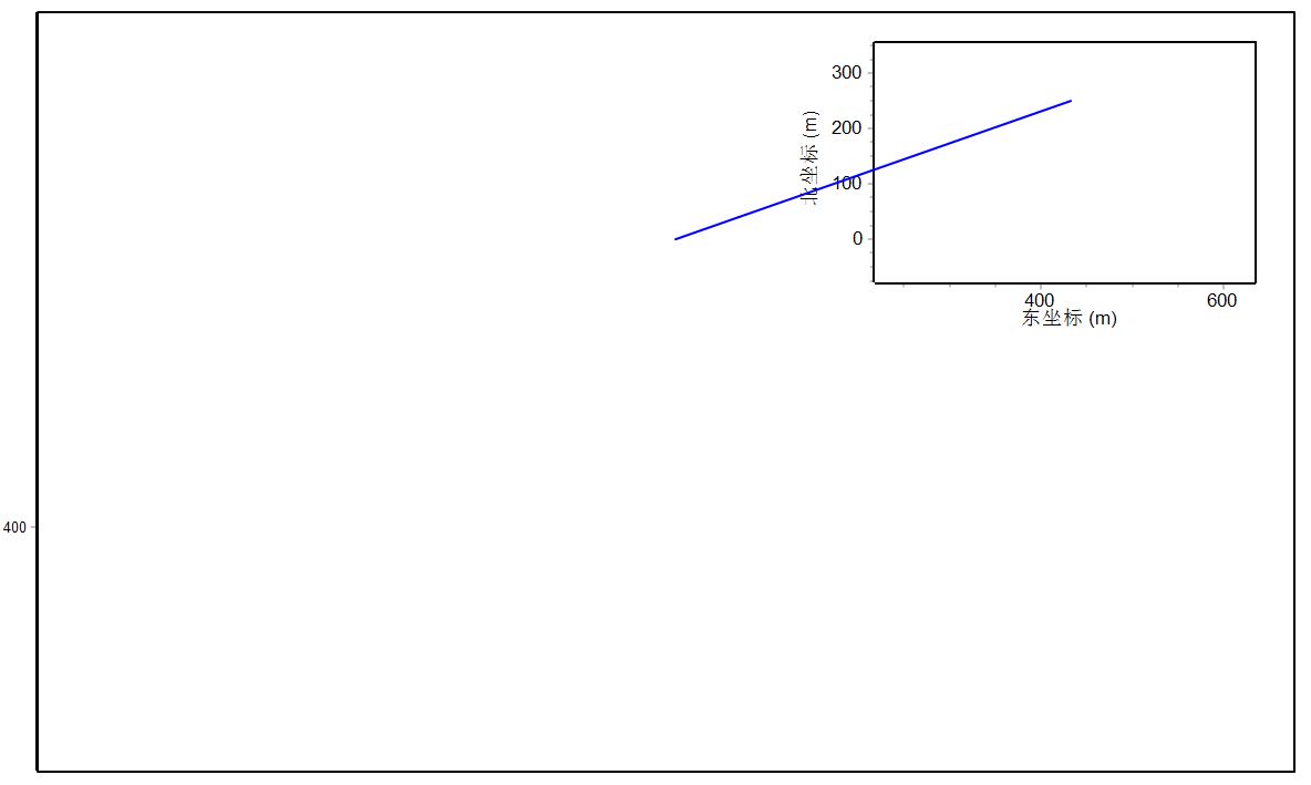

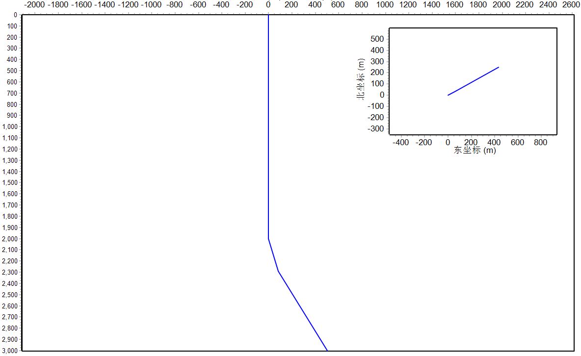

Using the same codes in another program, there are two weird results:
1.Axes Labels do not have the same size (see Fig-1), although I use the same codes to set the Chart and axes properties.
2. When click and zoom in the Sub Chart area, the Curves exceed the range of the Sub Chart area or CustomAxes range (see Fig-2).
