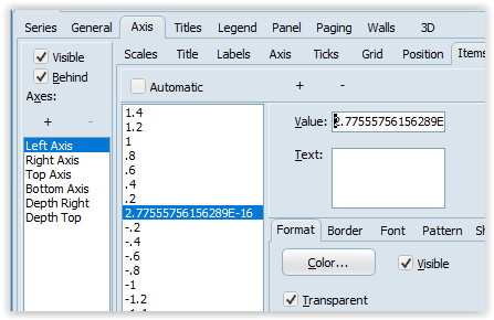

zero mark does not always display
Post by JimR » Sat Mar 11, 2017 6:55 pm
I have axes set to automatically display. Results usually good but sometimes I get a result shown on the attached screenshot. The '0' mark is not displayed on either the left or the bottom axes. Is there an option to force the '0' to always be displayed?

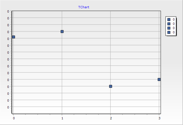

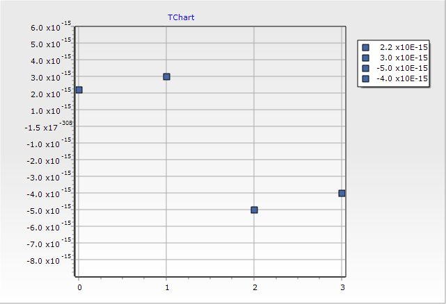

I'm trying to reproduce the problem but I always get all the axis labels drawn.
First, having values in the order of e-15, I get all the labels in the left axis rounded to 0:
uses Series, Math;
const exp = -15;
var base: Double;
  base:=Power(10, 15);
  Chart1.View3D:=False;
  with Chart1.AddSeries(TPointSeries) as TPointSeries do
    Add(2.2/base);
    Add(3/base);
    Add(-5/base);
    Add(-4/base);
  Chart1.Axes.Left.SetMinMax(-9/base, 6/base);
  Chart1.Axes.Left.LabelsExponent:=True;

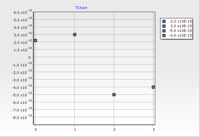

Using ValueFormat and AxisValuesFormat I an see the real values both in the legend and in the left axis labels.
In this case, I still see a label where the '0' should be, but it's represented as a really small value () instead of just '0':
uses Series, Math;
const exp = -15;
var base: Double;
    myValueFormat: string;
  myValueFormat:='#.# x10E-#';
    Add(2.2/base);
    Add(3/base);
    Add(-5/base);
    Add(-4/base);
    ValueFormat:=myValueFormat;
  Chart1.Axes.Left.AxisValuesFormat:=myValueFormat;
To solve it I can use OnGetAxisLabel event as follows:
procedure TForm1.Chart1GetAxisLabel(Sender: TChartAxis; Series: TChartSeries;
  ValueIndex: Integer; var LabelText: string);
var index, tmpExp: Integer;
  if (Sender=Chart1.Axes.Left) then
    index:=Pos('E', LabelText);
    tmpExp:=StrToInt(Copy(LabelText, index+1, Length(LabelText)));
    if tmpExp<exp then
       LabelText:='0';

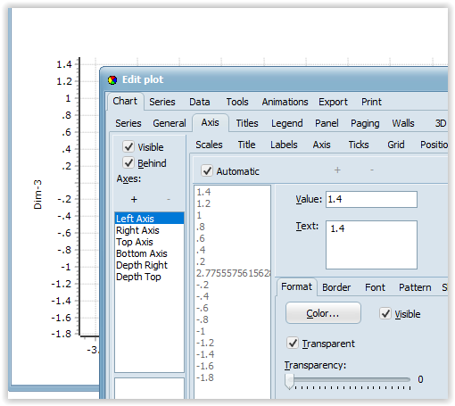

I have also found it difficult to construct a little test program to demonstrate the problem. I have attached screenshots to illustrate the problem and to show the values I find when I use the editor.
The lower plot shows a little of the left axis with the blank where a zero should be. I have overlapped it with the editor displaying chart.axis.items. You can see a strange value where one would expect a 0. The other screenshot shows what one gets after unchecking 'automatic' so I can widen the control so you can see the value (-2.77555756289E-16) that is there.
It looks like some rounding error in stepping from -1.4 to 1.4. Zero comes out a little off.
I hopes this helps clarify the problem.
Jim
Screen Shot 11-23-17 at 11.43 PM.PNG (15.69 KiB) Viewed 34140 times
With the control showing the values made wider to the 'zero' value can be seen.
Screen Shot 11-23-17 at 11.42 PM.PNG (25.98 KiB) Viewed 34144 times
