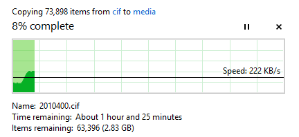

for some long running conversion we want to add a progress display with a graphical representation like Win 10 shows when copying a large amount of files:
What kind of series to use for this, or is there maybe some example code for that ?
Thanks and best regards

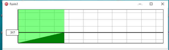

Thank you, using an Area series got me already a long way:
I have only one question left, I am using a TCursorTool to show the horizontal line with the current progress value.
Is there a way to show a custom text/string instead of the number, and then above the (TCursorLine) line on the right side in the frame ?
Just like in the Win10 dialog the string "Speed: 222KB/2". How to best solve that ?

Instead of modifying the TAnnotationTool embedded into the TCursorTool, I'd use a separated TAnnotationTool and I'd modify its position at the TCursorTool's OnChange event.
Here a simple example showing how to do this:
uses Series;
var annot1: TAnnotationTool;
  Chart1.View3D:=False;
  Chart1.Legend.Visible:=False;
  Chart1.Hover.Visible:=False;
  with Chart1.AddSeries(TAreaSeries) as TAreaSeries do
    AreaLinesPen.Visible:=False;
    FillSampleValues;
  with Chart1.Tools.Add(TCursorTool) as TCursorTool do
    Style:=cssHorizontal;
    FollowMouse:=True;
    OnChange:=CursorOnChange;
  annot1:=Chart1.Tools.Add(TAnnotationTool) as TAnnotationTool;
  annot1.Shape.Transparent:=True;
procedure TForm1.CursorOnChange(Sender:TCursorTool; x,y:Integer; Const XValue,YValue:Double;
                             Series:TChartSeries; ValueIndex:Integer);
  annot1.Text:=FormatFloat('#,##0.##', YValue);
  annot1.Left:=Chart1.ChartRect.Right-annot1.Width-5;
  annot1.Top:=y-20;

Thank You, that was exactly what I was looking for, this gives a very nice and generic progress display.
