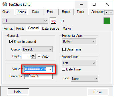

I'm trying to export series data in excel from tee chart editor. On exporting the excel gets series data as x and y columns in format of two decimal places. I want is to export data in scientific notation.
I had partial success by providing the format in series tab ->general here i can provide format for the values.
But this changes the format for both columns of the series. what i want is normal default format for x values of the series and scientific format for the Y series in the exported excel.
Please someone guide me how to proceed

Since the ValueFormat is a Series property, it is applied to both X and Y ValueLists. The only way around I can think on would be to use a temporal chart splitting each series into two series, one for the X values (with the default ValueFormat) and one for the Y values (with the modified ValueFormat). Ie:
