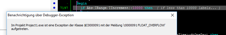

You need to comile and run it as 64bit application! Use the mouse, grab the right border of the applications main form and make the windows smaller until it crashes (the image below shows the form just before it):
A little bit further and you get this exception (text is in german but FLOAT_OVERFLOW is the thing happening):

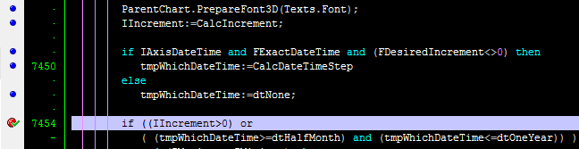

... So I tried to find the place where the error origins from and found TCgartAxis,Draw,DoDrawLabels
At the breakpoint (line 7454) IIncrement has the value mentioned in the previous post (and got calculated a few lines above).
This might be the place to patch the the problem (but maybe not to the best place to fix it).

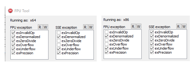

First of all FPU and SSE masks are set by Delphi and they are different for 32bit and 64bit applications. See the following screenshot:
Both screenshots are from my test application, and as far as I can tell those options are set with every start of an application.
Basically you can see that 32bit apps use FPU instructions while 64bit apps use SSE.
NOTE: If a checkbox is set, it means that this Exception is masked out (not thrown).

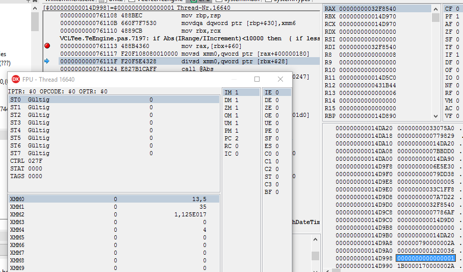

In 64bit mode on the other hand, SSE is used and here exOverflow is enabled (no check set). The division is made by:
divsd xmm0,qword ptr [rbx+$28]
and immeaditly raises the exception. No (other) errorflags could be observed, but thats most certainly the result of the exception handler.

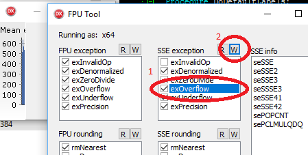

After that said, we can try and change the SSE exception mask:
and as you can see, the chart can be resized down to nothing without any exception!
I think, this is a acceptable solution (as programms in 64bit (hopefully) behave the same as in 32bit).
