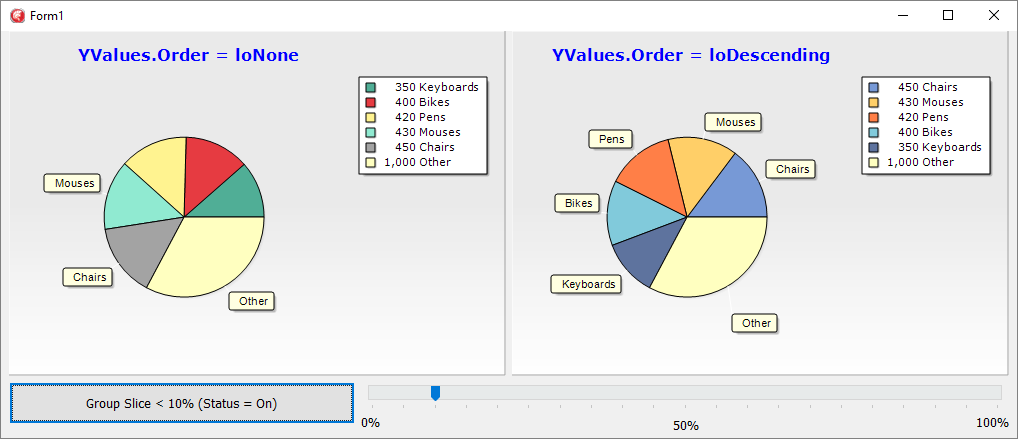

Post by NatSam » Sat Jan 28, 2017 1:10 pm
The color of the "group slice" is not the same of slice:
I´m using Delphi XE7 and Teechart (sources) 2016.19.161025.
Does anyone know how to solve this problem?
I registered this issue in Steema's support (#1757).
See sample project and print screen.
group.zip
Sample project and print screen
(116.24 KiB) Downloaded 804 times
Samuel (NatSam)

These are two different issues.
The #1749 is about the legend text is incorrect for slices of pie:
The above problem has been resolved by modifying the CalcLegendIndex() code.
The issue #1757 is about the color of "other" in legend is not the same of "Other" pie slice:
Samuel (NatSam)

I did some more testing and found something that might help solve this issue.
If I set the Y values in descending order, only the caption "Other" appears in the wrong color. If I do not order Y values (default), all captions in legend appears in the wrong color.

Re: The "group slice" color in legend is not same of the slice.
Post by Yeray » Tue Jan 31, 2017 3:00 pm
Are you using my fix proposal? This is how it looks for me with it:
