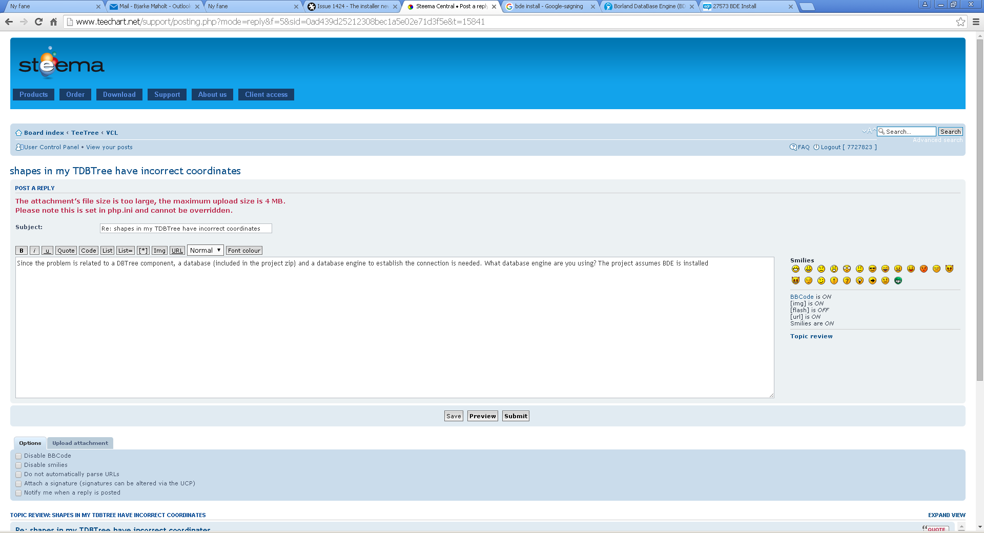

I couldn't upload the file here, first it said maximum size 4MB exceeded. After fitting the project to this requirement it says maximum allowed size 512KB.. (You might want to have a look at that)

I've attached a screenshot to this post. Produced by attempting to upload a 5MB file:The maximum file size allowed in these forums is 512KB.
I'm not sure what could be the message you got at first. If you get it again, please take a screenshot of it.

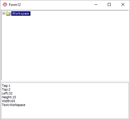

I could run your project and I've seen a single node on the tree.
Deppending on where I click, the information below changes, but the tree isn't expanded:
I see you aren't assigning parents on the nodes.

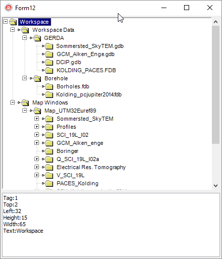

Modifying your FormCreate to assign the parents according to the xml, I get this:

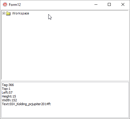

I'm glad you are able to reproduce our problem. As you can see, the richedit mirrors the node properties of the last clicked node. When that changes it is because the Sender node of the onClick-events varies depending on where you click, despite the fact that, according to the GUI, we are clicking the same (and only) displayed node each time. It follows that some nodes are misplaced in the tree in the current state.
Expanding the tree corrects the subnode placement so that we are able to select the root node correctly. I'd guess its the redraw that corrects the incorrect node positions.
