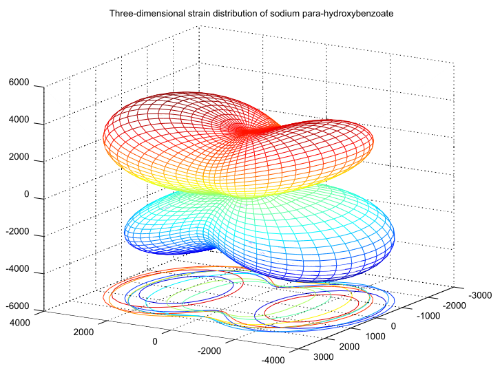

I would like to create this kind of plot with TChart:
unfortunately I can't attach the text file with the XYZ data (sph-strain.txt) !?
In Matlab / Octave the graphics is created like this:
m = 60
n = 60
strain = load ("sph-strain.txt"); # sequence of float. i.e: x,y,z …
X = reshape(strain (:,1),m,n); # reshape column1 into matrix 60x60
Y = reshape(strain (:,2),m,n); # .. 2
Z = reshape(strain (:,3),m,n); # .. 3
mesh(X,Y,Z); # call mesh, meshc, surf or surfc with X,Y,Z

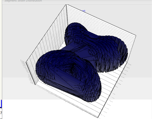

I tried to use TTriSurfaceSeries but then I get this:
Any Hint what I need to do or how I can upload the text file with the XYZ data ?

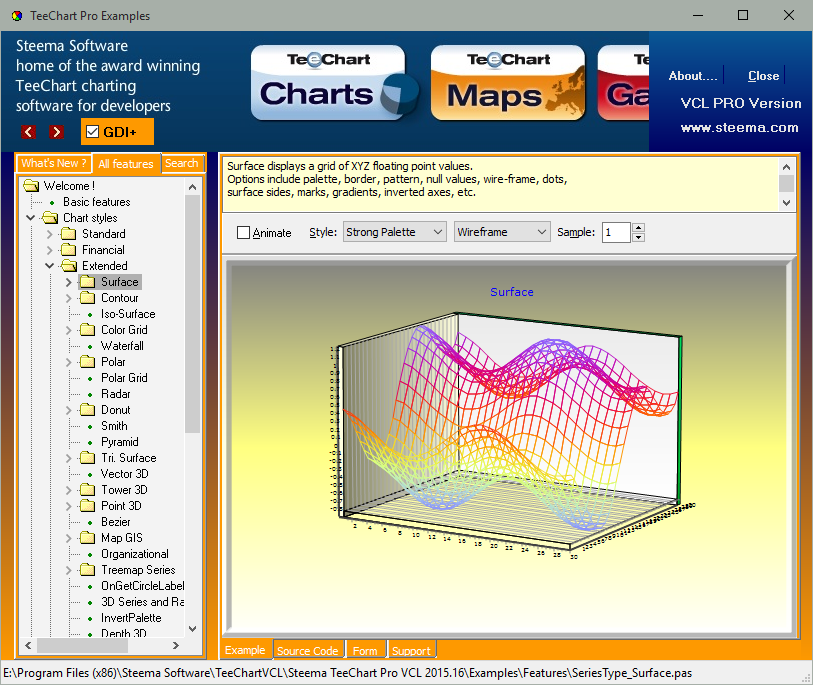

Have you tried setting the WireFrame property to True as in the Surface example?

a TSurfaceSeries doesn't show up at all when adding all the XYZ data and TTriSurfaceSeries doesn't have a WireFrame property.

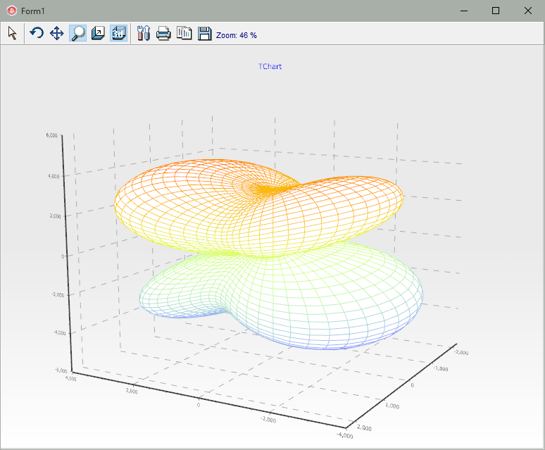

Using a TPoint3DSeries gives a better approach for me here with your data:
uses Series, TeePoin3;
var Series1: TPoint3DSeries;
var SeriesTextSource1: TSeriesTextSource;
  Chart1.Legend.Visible:=false;
  Chart1.Aspect.Orthogonal:=false;
  Chart1.Aspect.Zoom:=80;
  Chart1.Chart3DPercent:=100;
  Series1:=Chart1.AddSeries(TPoint3DSeries) as TPoint3DSeries;
  Series1.UseColorRange:=false;
  Series1.UsePalette:=true;
  Series1.OnGetPointerStyle:=Series1GetPointerStyle;
  SeriesTextSource1:=TSeriesTextSource.Create(Self);
  SeriesTextSource1.Automatic:=False;
  SeriesTextSource1.AddField('X',1);
  SeriesTextSource1.AddField('Y',3);
  SeriesTextSource1.AddField('Z',2);
  SeriesTextSource1.FieldSeparator:=#9;
  SeriesTextSource1.FileName:='F:\tmp\sph-strain\sph-strain.txt';
  SeriesTextSource1.Series:=Series1;
  SeriesTextSource1.Active:=true;
function TForm1.Series1GetPointerStyle(Sender:TChartSeries; ValueIndex:Integer):TSeriesPointerStyle;
  Series1.LinePen.Color:=Series1.ValueColor[ValueIndex];
  Result:=psNothing;
Note the SurfaceSeries expects the data to be in a specific format. See the post here.

The TriSurfaceSeries uses triangles (3 point planes) so it's more versatile than the TSurfaceSeries but it doesn't give a good result with your data either.
I see there are 60 points for each segment so it shouldn't be difficult to find what 4 points should be used to draw each cell.
And here it is!
Here the code I used:
uses Series, TeePoin3, TeeGLCanvas, TeCanvas;
  Chart1.Canvas:=TGLCanvas.Create;
  Chart1.Aspect.Zoom:=50;
  Chart1.Walls.Visible:=false;
  Chart1.Axes.Depth.Visible:=true;
  Chart1.Axes.Bottom.Inverted:=true;
  Chart1.Axes.Depth.Inverted:=true;
  Chart1.Axes.Depth.Increment:=1000;
  Chart1.Axes.Left.Increment:=2000;
  Chart1.Axes.Bottom.Increment:=2000;
  Chart1.Axes.Left.SetMinMax(-6000, 6000);
  Chart1.Axes.Bottom.SetMinMax(-4000, 4000);
  Chart1.Axes.Depth.Grid.Style:=psDash;
  Chart1.Axes.Left.Grid.Style:=psDash;
  Chart1.Axes.Bottom.Grid.Style:=psDash;
  SeriesTextSource1.FileName:='F:\Downloads\sph-strain\sph-strain.txt';
var p: array of TPoint3D;
    offset: Integer;
  offset:=60;
  if ValueIndex<Sender.Count-offset-2 then
    SetLength(p, 4);
    p[0].x:=Series1.CalcXPos(ValueIndex);
    p[0].y:=Series1.CalcYPos(ValueIndex);
    p[0].z:=Series1.CalcZPos(ValueIndex);
    p[1].x:=Series1.CalcXPos(ValueIndex+1);
    p[1].y:=Series1.CalcYPos(ValueIndex+1);
    p[1].z:=Series1.CalcZPos(ValueIndex+1);
    p[2].x:=Series1.CalcXPos(ValueIndex+offset+1);
    p[2].y:=Series1.CalcYPos(ValueIndex+offset+1);
    p[2].z:=Series1.CalcZPos(ValueIndex+offset+1);
    p[3].x:=Series1.CalcXPos(ValueIndex+offset);
    p[3].y:=Series1.CalcYPos(ValueIndex+offset);
    p[3].z:=Series1.CalcZPos(ValueIndex+offset);
    Chart1.Canvas.Brush.Color:=clWhite;
    Chart1.Canvas.Pen.Visible:=false;
    Chart1.Canvas.Polygon3D(p);
    Chart1.Canvas.Pen.Visible:=true;
    Chart1.Canvas.Pen.Color:=Series1.LinePen.Color;
    Chart1.Canvas.MoveTo3D(p[0].x, p[0].y, p[0].z);
    Chart1.Canvas.LineTo3D(p[3].x, p[3].y, p[3].z);
  Result:=psNothing;

Post by X-Ray » Mon Nov 02, 2015 8:38 am
Hello Yeray,
Great, that piece of code is very useful for other data and cases too.
Thank you very much!
