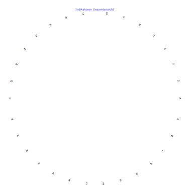

I try to export a TeeChart to a pdf-file. The chart is from the template gallerie, the Concentric Donuts.
After export, the chart is screwed-up.
At the pdf-file, there are only the marks from the chart but no chart.
Please can you help me?
sincerely yours
Peter

Hi Peter,

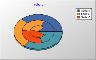

The concentric Donuts Template doesn't look as the one you posted above for me here.
Here it is how it looks for me:
And here it is the pdf I get with this code:

As an alternative, you could print the chart with a virtual pdf printer:
Chart2.zip
(15.82 KiB) Downloaded 857 times

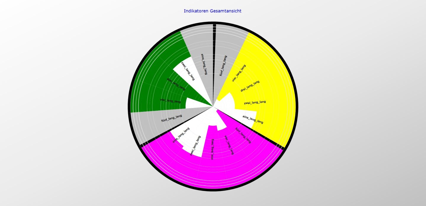

you are right, it looks a bit different but I use the concentric Donuts Template. I like to show the values as 100-perscent-columns, the middle of the circle is 100%. So I use the concentric Donuts and give all values the same width. Then I set the color of the values from outer (0%) to inner (100%) of the circle. What chart-type can I use as alternative to my solution? The new Rose Series show the values from inner circle to outer circle and use polar coordinates, but I need free scaling for the circle, not 360°.
Have you an idea what chart type better fit my needs?
Kind regards
Peter

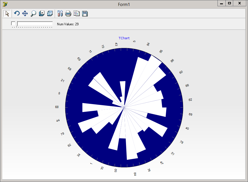

Hello Peter,
I've been trying to do a demo using the Rose series. I found some issues but I one problem I can't find how to workaround: some circle labels seem not to be drawn depending on the number of values.
RoseTest.zip
(2.04 KiB) Downloaded 846 times

Yeray wrote:I've been trying to do a demo using the Rose series. I found some issues but I one problem I can't find how to workaround: some circle labels seem not to be drawn depending on the number of values.
I've corrected the example above and this seems to work better.
Exporting to a pdf file works better than with the TPieSeries, but not perfect: the labels in the main chart disappear. However, printing the chart with a virtual pdf printer also works fine:

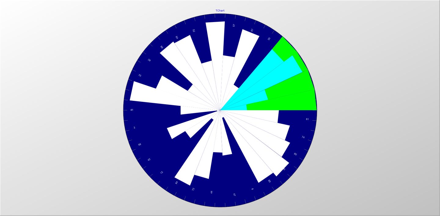

peterlepan
Posts: 10
Joined: Thu Mar 06, 2014 12:00 am
Re: PDF export screwed-up chart
Post by peterlepan » Tue Oct 07, 2014 6:32 am
your sample works fine, but I have one problem. I need to show the values from outer to inner. The outer of the circle is 0% and the center of the circle stands for 100%. If I show the difference to 100% with the rose-serie, I see no chance to change the color for a single value from outer to inner. These color is set with the CircleBackColor.
Oh, I have an idea! I use a second rose-serie to set the color of my single values!
Thank your for your inspiration!

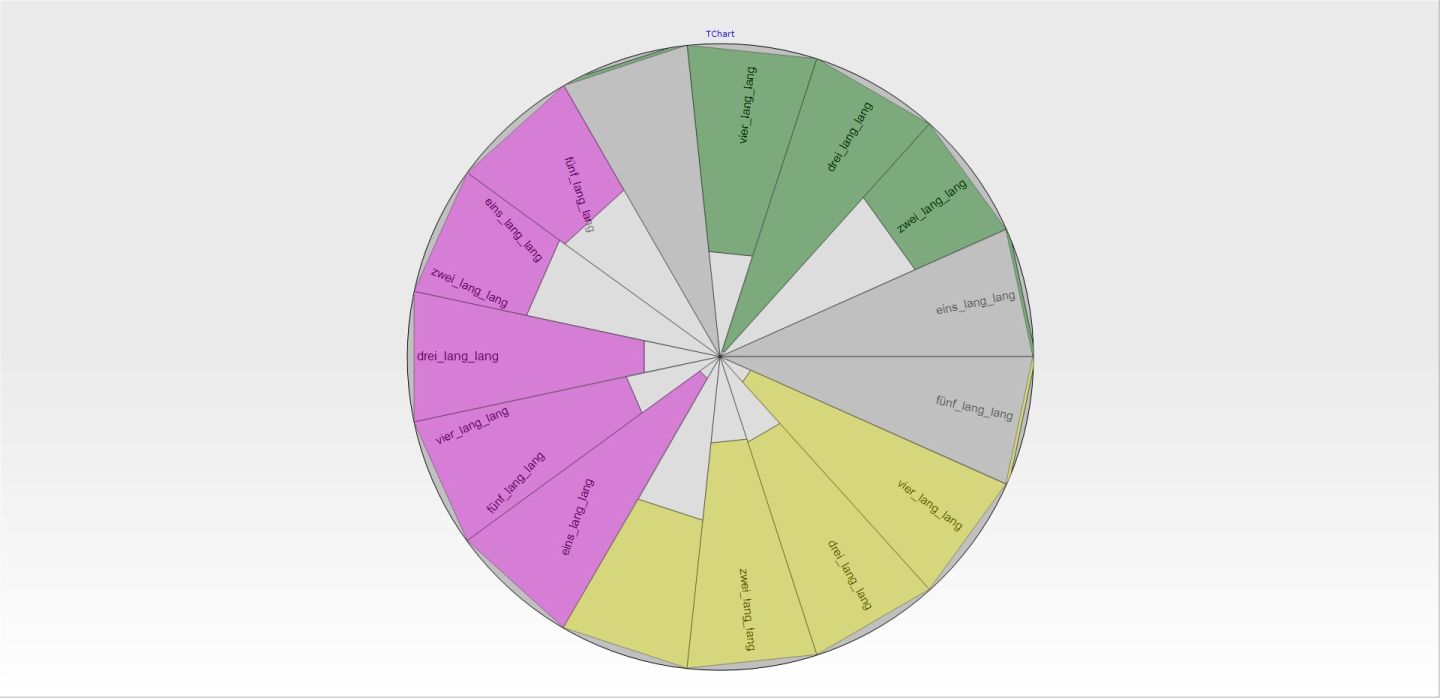

the rose serie has a cleaner look then the concentric donuts. But I have one Problem. I like to put the labels inside the circle, to save some space around the chart. If the labels-text get a bit longer then 3 numbers, the labels on the left side are not symmetric positioned to the labels on the right side:
The labels loose the assignment to its chart-values.
If I put the marks at the concentric donuts inside the circle, I nearly get a circle:
Each segment get its right label.
Is there an option at the rose serie, to position the labels in the circle without loosing the assignment to the values?
