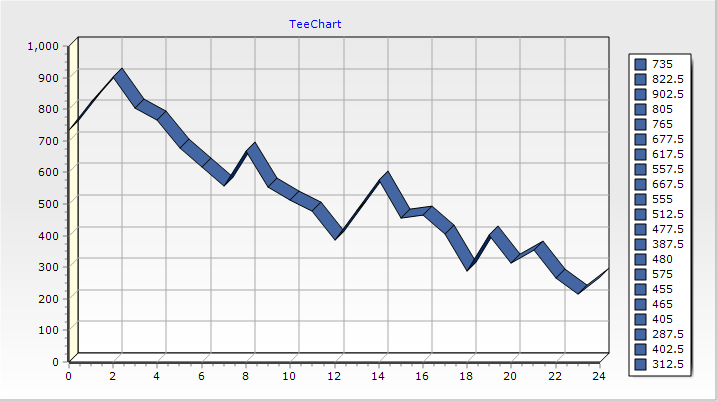

This is how it looks for me here:
Private Sub Form_Load()
  TChart1.AddSeries scLine
  TChart1.Series(0).FillSampleValues
  TChart1.Axis.Left.SetMinMax 0, 1000
  TChart1.Axis.Left.Increment = 100
End Sub
What space do you want to reduce?

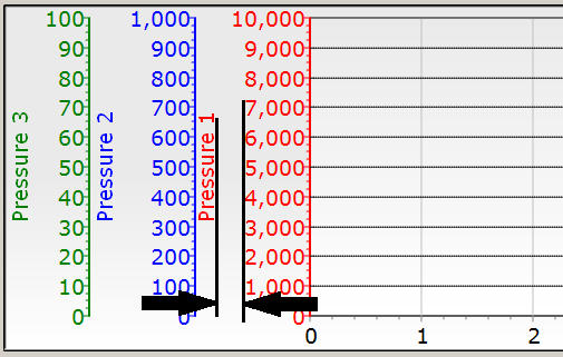

What I'm trying to do is change the spacing between the the 2 black arrows as shown on the picture below.

I'm afraid you can't control the axis title position.
Instead, you could hide the axis title and draw its text manually as follows:
  With TChart1.Axis.Left
    XPos = .Position - .Labels.MaxWidth - .TickLength
    YPos = .IStartPos + ((.IEndPos - .IStartPos) / 2) + (TChart1.Canvas.TextWidth(.Title.Caption) / 2)
  End With
  With TChart1.Canvas
    .RotateLabel XPos, YPos, TChart1.Axis.Left.Title.Caption, 90
  End With
