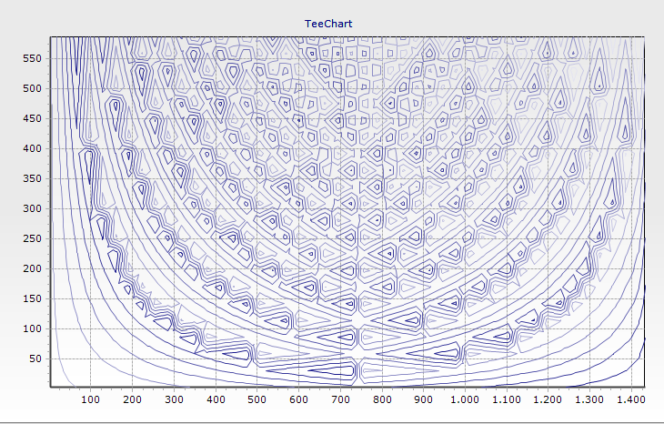

- Guru
- Posts: 1603
Re: How to draw contour from given data?
Actually, this probably works as you would better expect:
Which gives me this:
Contour contour = new Contour(tChart1.Chart);
contour.IrregularGrid = true;
Random rnd = new Random();
int count = Assignment_teechart.ContourData.ZValues.Count;
int y;
for (int x = 0; x < count; x+=46)
for (int z = 0; z < 47; z++)
y = x > 0 ? z * (x / 46) : z;
contour.Add(Assignment_teechart.ContourData.XValues[z], Assignment_teechart.ContourData.YValues[y], Assignment_teechart.ContourData.ZValues[x]);

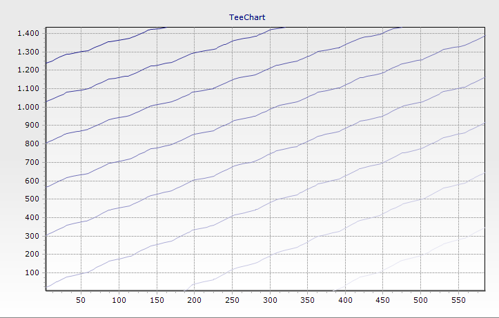

- Guru
- Posts: 1603
A third answer
Using and the following code:
I get this:
not as pretty as the last answer, but probably more faithful to the original data.
int length = Assignment_teechart.ContourData.ZValues.Count;
int y = 0;
for (int x = 0; x < length; x += 47)
contour.Add(Assignment_teechart.ContourData.XValues[x], Assignment_teechart.ContourData.YValues[y], Assignment_teechart.ContourData.ZValues[z]);
y++;
