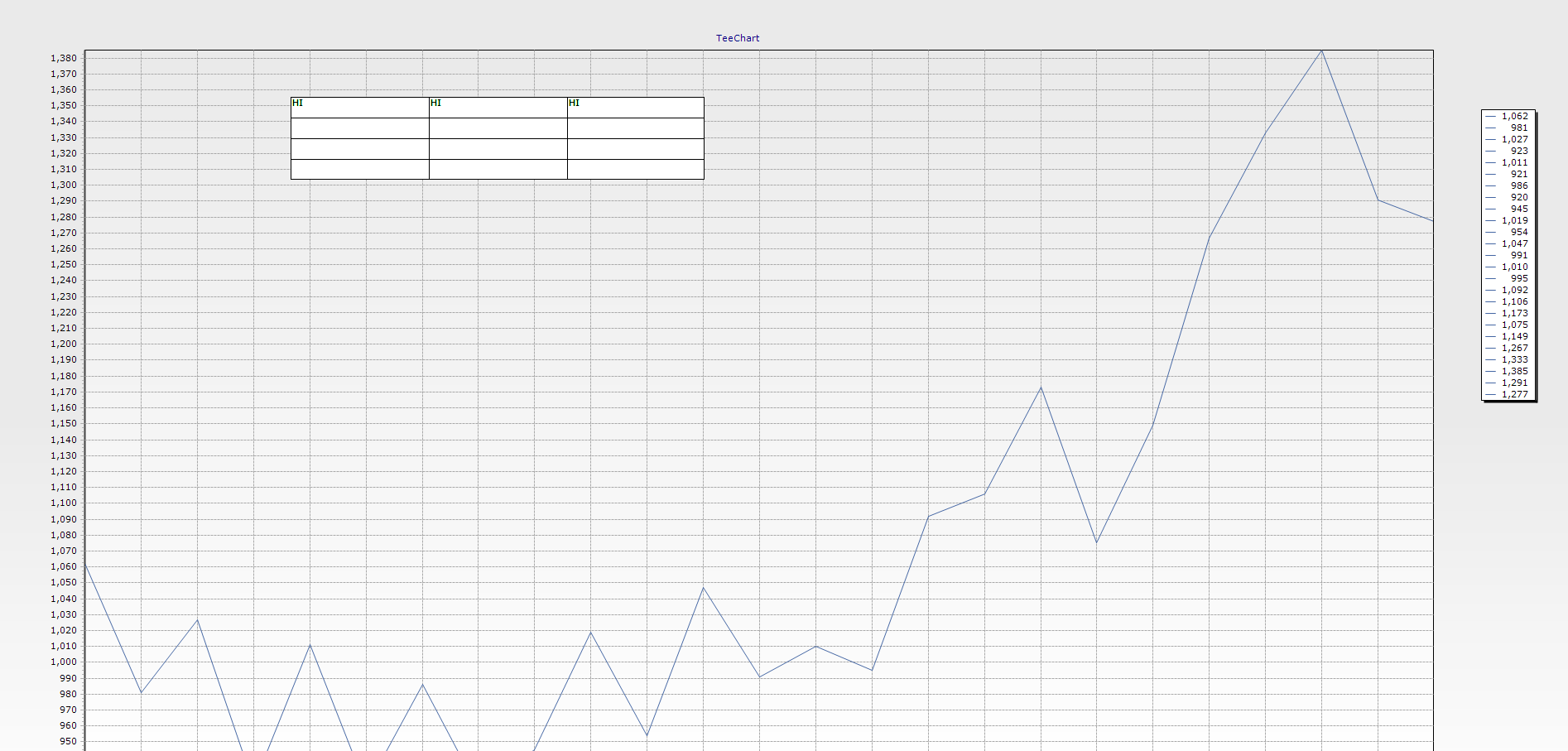

Hi Steema Support,
Can you write data in each row? We are using this g.TextOut(i, rect.Top, rect.Bottom - 1, "HI"); to write but this method write only one row not all. Image is attached
for (int i = rect.Left; i < rect.Right; i += horizIncrement)
g.VerticalLine(i, rect.Top, rect.Bottom - 1);
Thanks & Regards
PlanoResearch
Re: Grid in Rectangle tool
Post by Christopher » Tue Nov 25, 2014 9:59 am
Amol wrote:Can you write data in each row?
This is a basic programming task which is not TeeChart API specific. You could do something like this:
    protected override void ChartEvent(EventArgs e)
      base.ChartEvent(e);
      if (e is AfterDrawEventArgs)
        DrawGrid(Chart.Graphics3D, Bounds);
        DrawCells(Chart.Graphics3D, Bounds);
    private void DrawCells(Graphics3D g, Rectangle rect)
      int horizIncrement = Utils.Round((double)rect.Width / numCols);
      int vertIncrement = Utils.Round((double)rect.Height / numRows);
      for (int i = rect.Left; i < rect.Right - 1; i += horizIncrement)
        for (int j = rect.Top; j < rect.Bottom; j += vertIncrement)
          g.TextOut(i, j, "BYE");
