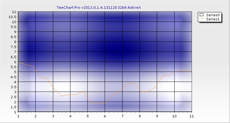

zrandlbs wrote:I used colorGrid to make a map.Now I want to draw a line on colorgrid and to create a profile section.Would you give me any suggestions?I do not know how to get the coordinates and values of the intersection points between the line and colorgrid.
I'm not sure to understand what problem have you found when trying to do it.
I've been able to draw a ColorGrid and a Line series in the same chart:
Private Sub Form_Load()
  TChart1.Header.Text.Clear
  TChart1.Header.Text.Add TChart1.Version
  TChart1.Aspect.View3D = False
  TChart1.AddSeries scColorGrid
  TChart1.Series(0).FillSampleValues
  TChart1.AddSeries scLine
  TChart1.Series(1).FillSampleValues
End Sub

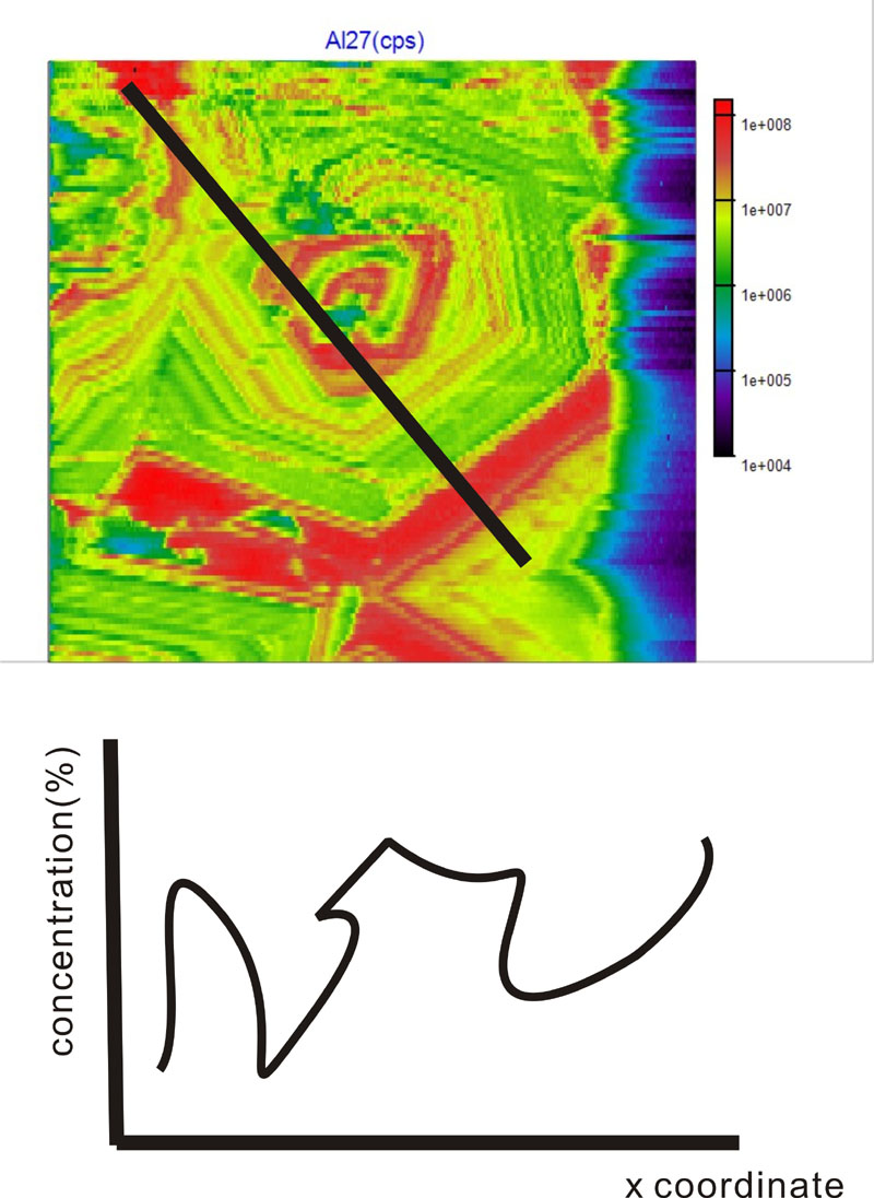

Thank for your quick reply.I used colorgrid to generate an image that the grid color is concentration of an element.Now I need to allow users to draw a line on my image to generate a section along the line. I need to get values of the colors and coordinates on the line.
Because the line is drawn by users,so I think I should use "draw line" tool.
I think the key problem is how to get the coordinates of crossing points between the drawn line and my image.I drew a picture for you. In my picture,Y axis is concentration of Al and x axis is distance of the drawn line on colorgrid.
Good luck!
Robinson

zrandlbs wrote:Thank for your quick reply.I used colorgrid to generate an image that the grid color is concentration of an element.Now I need to allow users to draw a line on my image to generate a section along the line. I need to get values of the colors and coordinates on the line.
The Clicked(X, Y) function of the ColorGrid will give you the index of the cell under a given pixel. However, you still have to calculate the list of pixels in that line, and I'm afraid you should do it manually. I've taken the code from here to make a simple example. Take it as a start point:
