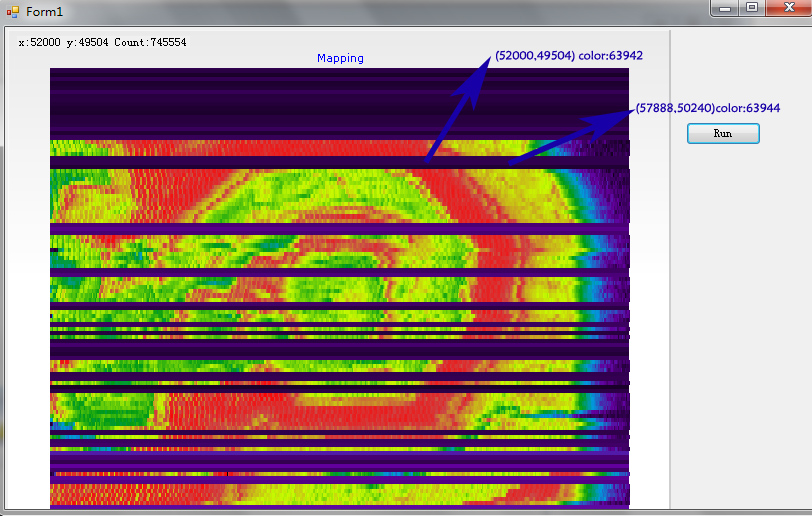

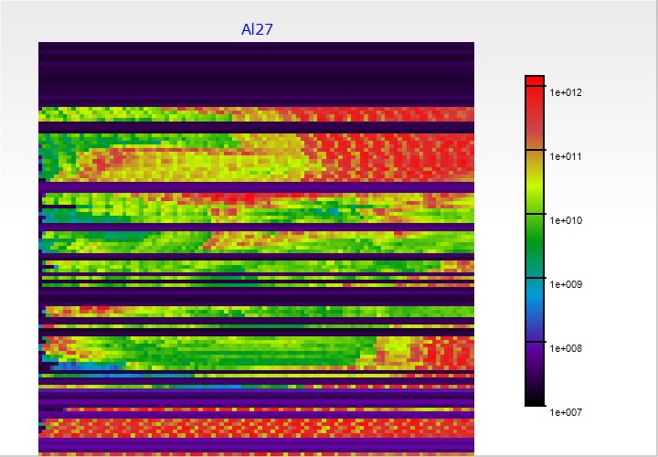

I am using colorgrid for mapping with C#. xCoordinate, yCoordinate are coordinate array ,zValue is the value of x-y, c is different colors , programme is :
TChart2.Series(0).asColorGrid.IrregularGrid = true
for (int i = 0; i < MyDb.zValue.Length; i++)
UInt32 c = MyDb.allocate(MyDb.zValue);
TChart2.Series(0).asColorGrid.AddXYZ(xCoordinate, zValue, yCoordinate, "", c);
sometimes I can work out images,but sometimes I cannot, see attached. I checked the original data of black color in images, the color should not be black.I wonder if data are large(about 50000 records)
Now if I use addarrayXYZ(x,z,y) to replace addxyz to finish the same task. z represents color, how I define z in c#?
thanks,
How to use AddArrayXYZ method in color grid
- failed image
- p1.jpg (101.39 KiB) Viewed 18347 times

Re: How to use AddArrayXYZ method in color grid
Yeray,
Thank you for your answer instantly. I find I cannot show the color rightly. I mark two points that show color incorrectly(see my images).
I give you a simple programme, Please help me to check it. I hope there were no black(or blue) bars in it.
I appreciate your great help.
thanks,
robinson.
thanks,
robinson.
- wrong image
- question.jpg (317.65 KiB) Viewed 18238 times
Hi Robinson,
I can't see the attachment. Don't you get an error message indicating what's wrong?
If you still find problems with it, you can post your files at our upload page or directly send them to us at "info at steema dot com" by mail.
