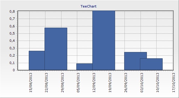

Using TeeChart for .NET build 4.1.2013.07300 and this code snippet:
      tChart1.Axes.Bottom.Increment = Steema.TeeChart.Utils.GetDateTimeStep(Steema.TeeChart.DateTimeSteps.OneWeek);
      tChart1.Axes.Bottom.MinorTickCount = 6;
      Steema.TeeChart.Styles.Bar bar1 = new Steema.TeeChart.Styles.Bar(tChart1.Chart);
      bar1.XValues.DateTime = true;
      bar1.BarWidthPercent = 100;
      bar1.Marks.Visible = false;
      Random y = new Random();
      for (int i = 0; i < 10; i++)
        DateTime dt = DateTime.Now;
        if (i != 5)
          bar1.Add(dt.AddDays(i * 7), y.NextDouble());
I get this chart:
Where bars slightly overlap. Is this the problem you describe? I have added this defect (TF02016686) to the bug-list to be fixed for future releases.

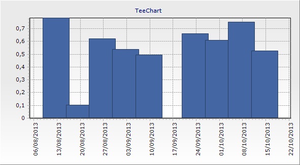

Hi Janne,
Could the occational lack of values along the axis be aggravating the problem, you think?
Yes, adding more gaps:
        if (i % 3 != 0)
makes it worse:
While having no gaps draws it correctly.
