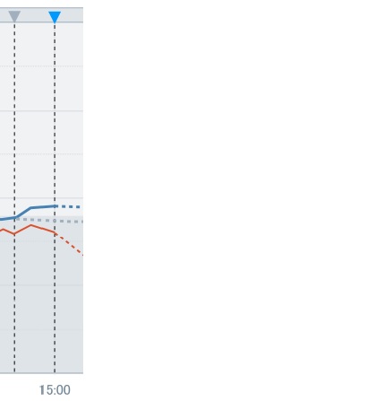

How can I draw/put triangle on Teechart CursorTool which need to have a look like image below.
[img]
[/img]
This triangle should behave as a gripper when we click and drag to help moving the cursor dynamically.
Please help me to achieve this.

Hello gilbert,
I haven't forgotten your request, but I am working to find a good solution for you. I try to answer you asap.

I have made a simple code where there is drawn a triangle directly in the canvas and is used the x value of cursor to move it.

Could you please tell us if previous code works in your end?

Hi Sandra,
Thank you so much for the help.It works fine.
I have used some part of the code in my application, the triangle is moving with my cursor perfectly
but I am unable to set triangle position exactly on cursor's top.
And the triangle size is varying(height) when I change window size to minimize or maximize.
Also, I would like to show the triangle always on the cursor irrespective of the cursor's movement ie., triangle position should take the cursor's position so that triangle will be on top of the cursor.
I am binding the tchart using a collection of data from csv file to show line series.
I guess it works only with the random data.
please help me.
Re: Customizing cursor tool look and feel
Post by Sandra » Thu May 09, 2013 2:29 pm
Hello gilbert,
I have modified my previous code because do as you want:

Hi Sandra,
Thank you for the code.It really helped my requirement.
I have one more concern here.
Scenario 1:
The cursor and the cursor's traingle should move only when i move the cursor manually which is working fine.
The cursor's traingle should get visible on loading the teechart itself.
Right now it is being displayed when I move the cursor.
On scrolling over the teechart, the cursor's triangle is moving when the cursor is not moving.
I would prefer if i scroll the teechart also, the cursor's traingle should not move as cursor does not move.
Scenario 2:
I have second cursor on the same teechart along with first cursor which should not be movable.
This cursor will take the current value of x axis and gets changed dynamically.
I am able to show another traingle on the teechart but unable to set its position on top of this cursor because this
cursor is not movable manually.
Scenario 1 cursor is my past cursor which can be movable and am able to show the triangle exactly on it.
The problem is when the scenario 2 cursor value changes, past cursors traingle should be visible exactly on it.
For scenario 2, cursor is current cursor which should not be movable but traingle should be visible exactly on top of
it whenever its value changes or scroll the teechart.
I have tried the code but didnt get the correct solution since 2nd cursor is not movable to handle it in mouseMove event.
Kindly let me know if am not clear.Please help me.

Hello gilbert,
Your requirements force me to modify again my code, so you can get an idea as you need do. For this reason, I recommend you taking a look to my code and change the events or variable, if it is necessary, because, your code is behaved as you like:

            //Rect
            Rect rect = tChart1.Chart.ChartRect;
            if (IsChangeCursor)
                X = pos.X;
                g.BackColor = Colors.Blue;
                Rect rect1 = new Rect(X, rect.Top - 10, 20, 20);
                points = new[]
                  new Point((X-rect1.Width/2) + rect1.Width,-((rect.Top-tChart1.Panel.MarginTop+5) -(rect1.Height))),
                  new Point((X-rect1.Width/2),-((rect.Top-tChart1.Panel.MarginTop+5)-(rect1.Height))),
                  new Point((X-rect1.Width/2)+rect1.Width/2,(rect.Top+tChart1.Panel.MarginTop+20)/2)
                g.Triangle(points[0], points[1], points[2], 0);
                points1 = new[]
                  new Point((previousC-rect1.Width/2) + rect1.Width,-((rect.Top-tChart1.Panel.MarginTop+5) -(rect1.Height))),
                  new Point((previousC-rect1.Width/2),-((rect.Top-tChart1.Panel.MarginTop+5)-(rect1.Height))),
                  new Point((previousC-rect1.Width/2)+rect1.Width/2,(rect.Top+tChart1.Panel.MarginTop+20)/2)
                g.Brush.Color = Colors.LightGray;
                g.Triangle(points1[0], points1[1], points1[2], 0);
