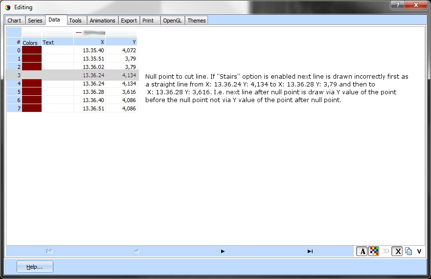

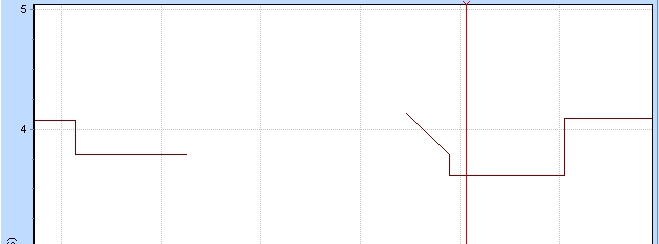

TeeChart 2012.0.0.9 ActiveX component. Line series with "stairs" option selected and null point in series to cut line. First line section AFTER null point from (x.1, y.1) to (x.2, y.2) is not drawn correctly (x.1, y.1 -> x.2, y.1 -> x.2, y.2) but using y value BEFORE null point i.e. (x.1, y.1 -> x.2, y.-1 -> x.2, y.2). Pictures of a sampe data and the resulting line series attached.

Line is not drawn correctly. We did not have this problem with TeeChart ActiveX 8 with the same code.
Re: "Stairs" line series with null points is not drawn correctly
Post by Yeray » Tue Apr 30, 2013 9:01 am
I found a fix for it (TV52016561). The next maintenance release will include it.
