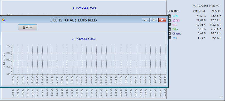

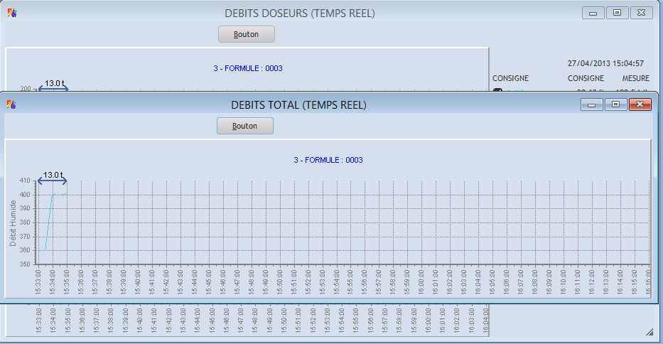

I have two windows, one in each chart window.
The increment of the X axis is 30 seconds.
I want 10 pixels for 30 seconds.
X minimum is 27/04/2013 3:33:00 p.m..
PROCEDURE FORMLOAD ()
CALCULBOTTOMAXIS ()
PROCEDURE OnResize ()
CALCULBOTTOMAXIS ()
PROCEDURE CALCULBOTTOMAXIS ()
StartPos is int = TChart1 >> Axis >> Bottom >> IStartPos EndPos is int = TChart1 >> Axis >> Bottom >> IEndPos lr30Sec is a real = TChart1 >> GetDateTimeStep (dtThirtySeconds) pixels is an integer = 10
MaxDateHeure MinDateHeure + = (((EndPos - StartPos) / pixels) * lr30Sec)
TChart1 >> Axis >> Bottom >> Maximum = gfrMaxDateHeure
before increasing the size of the window the two scales are correct
after having increased the size of the window the scales are not identical
do you have a solution to keep 10 pixels for 30 seconds
the scale of x-axis change after increase the size of window
- AFTER INCREASE SIZE OF WINDOWS.PNG (22.75 KiB) Viewed 21640 times
- BEFORE INCREASE SIZE OF WINDOWS.PNG (24.44 KiB) Viewed 21633 times

Re: the scale of x-axis change after increase the size of window
the scale is wrong after restoring then window and after a resize.
take a look on the attachment there is a small difference.
5 PIXELS ENV.
THE SIZE OF X-AXIS IS 625 PIXELS
