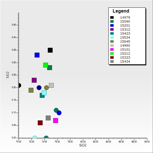

I am having trouble displaying chart symbols in the chart legend of of one of my apps. The symbols (pointer styles) will not display in the legend, although the colors are correct.

Sorry, this did not work for me.

I am using the latest version. If I use the code in a new (different) application, it works fine. There is some problem with the configuration of the existing application to stop the Legend from working properly. Everything else in the Tchart works fine. Any ideas, apart from deleting the Tchart and starting from the beginning?
