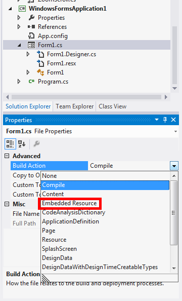

Post by Narcís » Fri Jan 11, 2013 9:16 am
Hi Matt,
At some point the project settings changed. We are confused why or how this could have happened. Do you know if there is anything the Dev Studio UI that controls this? Meaning that someone might have accidentally changed this setting? It's quite strange.
This was probably accidentally changed at Form's "Build Action" property as shown here:

Post by biqpaulson » Fri Jan 11, 2013 12:52 pm
Perfect! Thanks Narcís.
