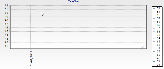

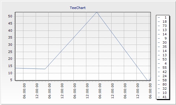

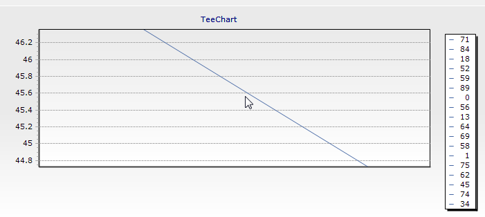

thanks for the snippet. I made a new c# project, added the tchart control and dropped in your code. I am using tchart pro .Net V2010 V4.1.2012.5103
Unfortunately, the resulting axes are unacceptable. The initial axes look fine, but as I zoom in the dates are replaced with a single axis label containing a time stamp. 1 vertical line + a label is not a satisfactory set of labels. we need at least 2.
If I continue to zoom in, the single label disappears and I get nothing on the bottom axis at all.

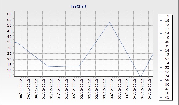

Re: Problems with Bottom Axis in date time mode
Post by Sandra » Fri Nov 23, 2012 9:52 am
Hello Paul Kennedy,
Ok. In my first code I have defined the style of labels as PointValue and only appears the label of each point. So, I have commented it from my code as you see next:

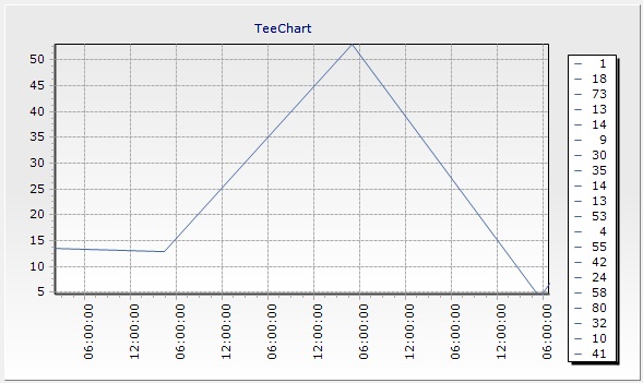

And using previous code I have gotten next results:
Image 1:
Image 2:
Image 3:
Could you please check, if my code works in your end, in your version of TeeChartFor.Net? Also, I have realized that you don't use last version of TeeChartFor.Net I recommend you update your version of TeeChartFor.Net and check again my codes in latest version to sure the problems are solved. You can download it in the customer download page.

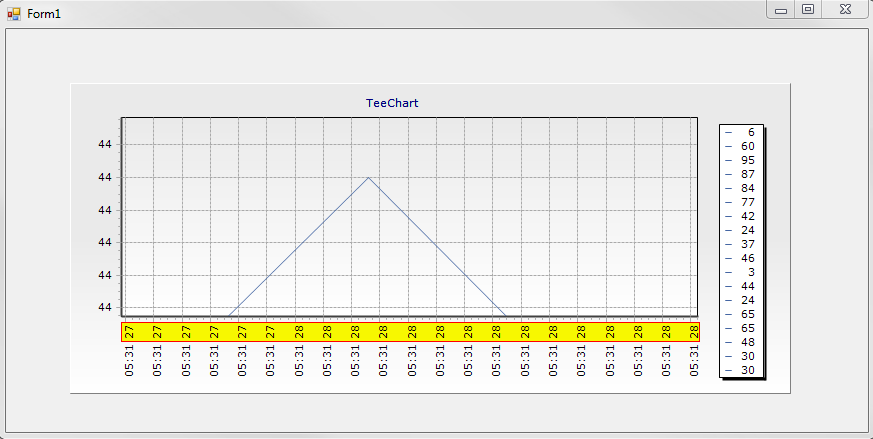

I downloaded and installe dhte latest verison of teechart.net.
I then took your revised sample code, and can see more axes labels, but the auto interval still creates useless labels. As you can see in the highlighted area, we still see integer seconds, so the plot is still useless to users.
Auto mode really should do this out of the box. If not, there is no point having an auto-mode!

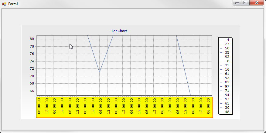

[img]DateTimeAxesProblems.png[/img]
Paul Kennedy
Posts: 6
Joined: Mon Jul 30, 2012 12:00 am

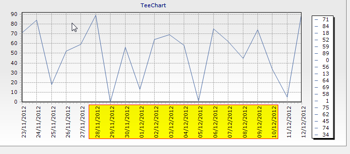

Post by Paul Kennedy » Wed Dec 05, 2012 7:23 am
Your code sample also fails with medium sized zooms. In this example , the axes are still ambiguous, and hence useless.
I believe this really needs some attention, as the current handling of dates on the axis is pretty terrible.
[img]datetimeaxesproblems2.png[/img]
