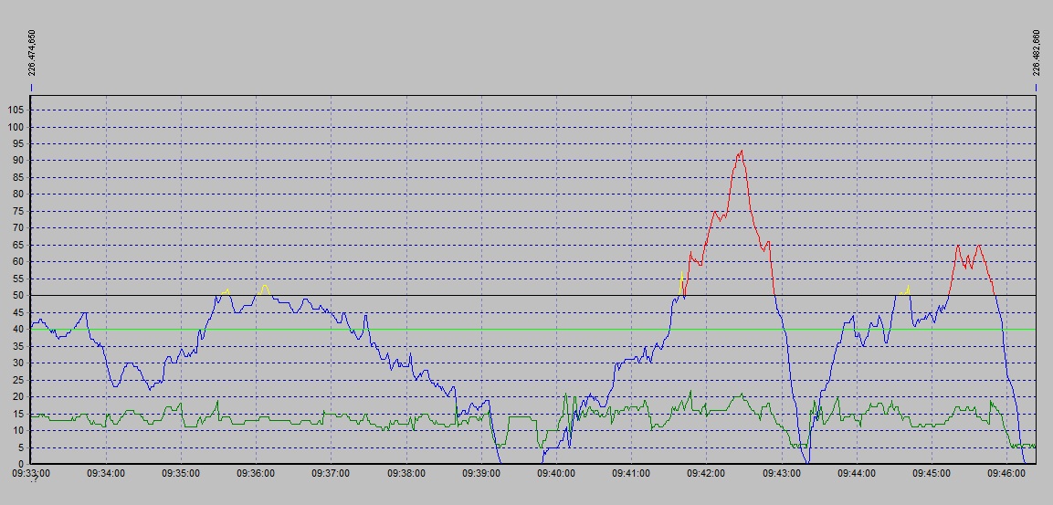

Dear friends,
I need to change the line color of a line chart based on a condition,
In one part blue and the other red.
As in the example file "chart.jpg."
Someone can tell me how can I do this?
Att
Osvano.

It looks to me like you cannot reproduce your example chart using a single Line series in the TeeChart. You can make your series' pointers visible and have a condition-based color for each pointer. Alternatively you can use a new Line series for each contiguous stretch of color that you want to display.

Hello Rob Cooke
First, thank you for ideas.
When you say
"You can make your series' pointers visible and have a condition-based color for each pointer" would be done like this?
You have to send me an example?
I thank your attention,
Osvano.

Something like the code below. This isn't particularly well-documented, but your question was interesting to me so I spent a little time looking through teechart.js to see what was available.
var Y = [{ array of series values } ];
var X = [{ array of series x-axis values } ];
var c = [{ array of HTML color values, one for each point in the series (ex. "#FF0000" ) } ];
var cht = new Tee.Chart("canvasID");
var srs = new Tee.Line();
srs.data.values = Y;
srs.data.x = X;
srs.palette.colors = c;
srs.colorEach = "yes";
srs.pointer.visible = true;
cht.addSeries(srs);
