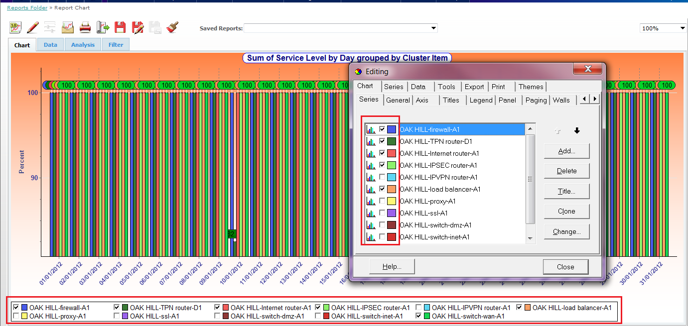

We used the Teechart7 in our product. There is an issue about checkbox in the chart. Our customer doesn't plan to upgrade product(they will continue to use our old version product, which contains Teechart7). Could you please provide a fix for this?
Issue description:
The checkbox can't be checked/unchecked in the Chart when there is many Series. But in Editing dialog selecting/unselecting the checkboxes work fine.
I attached the snapshot. We can provide the issue environment if you need.
Issue description:

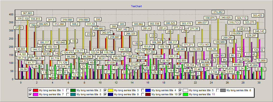

Hi Chen,
I've tried to reproduce it in VB6 and TeeChart ActiveX v7.0.1.6 with the following code but the checkboxes in the legend still seem to work for me here:
Could you please try the code above?
If you still have problems with it, please try to arrange a simple example project we can run as-is to reproduce the problem here. Or modify the code above with the same purpose.
TChart1.Aspect.View3D = False
TChart1.Legend.CheckBoxes = True
TChart1.Legend.Alignment = laBottom
Dim i As Integer
For i = 0 To 10
TChart1.AddSeries scBar
TChart1.Series(i).FillSampleValues 31
TChart1.Series(i).Title = "My long series title " + Str$(i + 1)
If i Mod 2 <> 0 Then
TChart1.Series(i).Active = False
End If
Next i

After my customer applied the latest version of teechart v7, the problem still exist. and he also said the problem still exist in teechart v2010. So I hope you can tell me how you can resolve the problem.
I can describe the problem first.
Normally customer fill in lots of data to teechart. and the chart only display few data. after drill down, the chart can display more data. user couldn't click parts of checkboxes. I had uploaded the screenshot several months ago.
If you can check my customer via one remote seesion. I think you can easily understand the problem.
If you couldn't check my customer, would you please tell me the way how you can resolve the problem?

Ok, thanks for checking it.Chen Yang wrote:After my customer applied the latest version of teechart v7, the problem still exist. and he also said the problem still exist in teechart v2010. So I hope you can tell me how you can resolve the problem.
What drilldown? Do you mean the editor? When the editor is opened, the chart isn't interactive until you close the editor window.Chen Yang wrote:I can describe the problem first.
However, I'm not sure this is what you mean, because it happens regardless of the number of series or points you have.

drill down means, there is 1 bar, after 1 clicking on this bar, detailed data will be shown by a number of other bars. For instance, there is 1 bar show 30 in total for 1 vertain month, after drill down, detailed data for every single day of this month will be shown by 28/30/31 small bars.Yeray wrote:What drilldown? Do you mean the editor? When the editor is opened, the chart isn't interactive until you close the editor window.Chen Yang wrote:I can describe the problem first.
