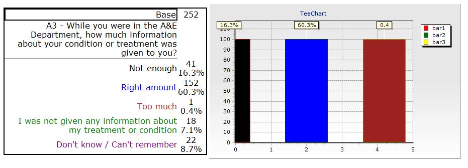

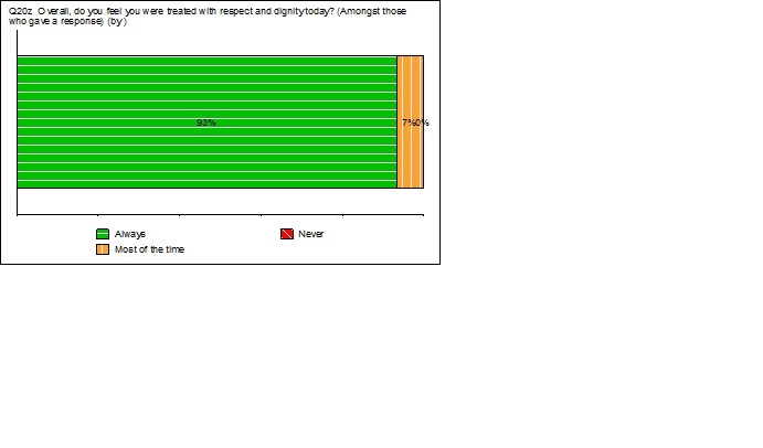

Trying to achive a graph as per sample, I have tried an area graph, but I only have 1 value for each response, so all I get is all in the left hand column, I need to fill the area 100%, so was thinking the area graph is what is needed

Sorry for the delay. I think should be useful for you, use a customBarSeries as do in the example of Demo All Features\Welcome !\Chart styles\Standard\Bar\Bar Size example. As you see in this example is used a custom series to change the size of Bars. I have made a simple project where try to achieve as you want using a CustomBarSize class and changing the size and positions of Bars.

Thanks, your demo worked fine apart from can't see how the invert works as this did not work, I have added my 3 of my values to the data, but is not right, see attached

I have made a simple code to adapt the bars at your values:
        CustomBarSize bar1, bar2, bar3;
            bar1 = new CustomBarSize(tChart1.Chart);
            bar2 = new CustomBarSize(tChart1.Chart);
            bar3 = new CustomBarSize(tChart1.Chart);
            bar1.Add(1, 100, "16.3%", Color.Black);
            bar2.Add(2, 100, "60.3%", Color.Blue);
            bar3.Add(3, 100, "0.4%", Color.Red);
            bar1.SideMargins = false;
            bar2.SideMargins = false;
            bar3.SideMargins = false;
            bar1.SizeValues[0] = 1.63;
            bar2.SizeValues[0] = 6.3;
            bar3.SizeValues[0] = 0.04;
            bar1.XValues[0] = 0;
            bar2.XValues[0] = 2;
            bar3.XValues[0] = 5.1;
            tChart1.Axes.Bottom.Labels.Style = AxisLabelStyle.Value;
            tChart1.Axes.Bottom.SetMinMax(-2, 5.2);
            tChart1.Axes.Bottom.Increment = 1;
            tChart1.Axes.Bottom.MinimumOffset = 1;
            tChart1.Axes.Bottom.MaximumOffset = 1;
Can you tell us if previous code help you to achieve as you want? As you see you need modify the Xvalue to adapt your data.

I can see how the below are done, and can do formula:-
The XValues I can't work out,
The graphs will have vary number of columns, from 2 upto 9

Post by Narcís » Thu Jul 26, 2012 9:28 am
Hi mikethelad,
You could do something as in the All Features\Welcome !\Chart styles\Standard\Area\Sales vs. Price example in the features demo where Area series is being used.
