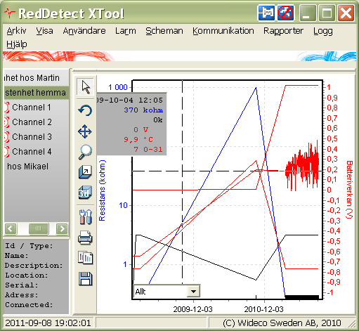

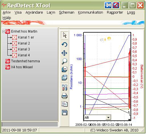

Helllo!
Well, its not a bug! But if you se the two attached pictures, in "full view.jpg" the tree at the left It is presented as I want it to be. In the "scrolled.jpg" picture you can se how it looks if it does not fit. In this case I would still want it to be left justified and the horizontal scrollbar removed/invisible (and in leftmost position).
Regards, Mikael
Regards, Mikael
- Full view.JPG (134.82 KiB) Viewed 104547 times
- Scrolled.jpg (165.3 KiB) Viewed 104512 times
