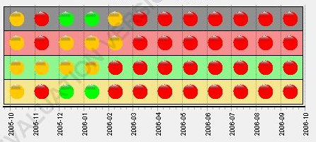

I 'm using bubble series, and the current effect is shown below, where the labels lie in the left of the bubbles. But I want the labels to be in the middle of the corresponding bubbles.
I browsed the topics in the forum and didn't find any related questions. Actually, I found few question about bubble series. I also browsed the Teechart tutorial but found few information about this.
Much appreciate if anybody had advises.
Current effect

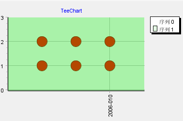

Pls, in the above picture, the X-labels are from 2005-10 to 2006-9. And in fact, the bubble series are from 2005-11 to 2006-10. Which means that the label starts one month early than the bubble date. I tried this method:
ch1.getChart().getPanel().setMarginLeft(15);
and only got this:
In this picture, the label "2005-10" is needless, and the labels stand on the left of the corresponding bubbles.

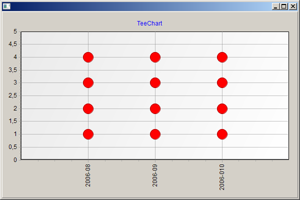

Trying to reproduce your situation, here it is the result I'm getting with the code below:
	private static void initializechart() {
        tChart1.getLegend().setVisible(false);
        Bubble bub1 = new Bubble(tChart1.getChart());
        for (int col=1; col<4; col++)
        	for (int row=1; row<5; row++)
            	bub1.add((double)col, (double)row, 0.2, "2006-0"+(col+7), Color.red);
        tChart1.getAxes().getLeft().setMinMax(0, 5);
        tChart1.getAxes().getBottom().setMinMax(0, 4);
        tChart1.getAxes().getBottom().getLabels().setAngle(90);
I'm probably doing something different than you. Could you please try to modify the code above so we can be reproduce the problem here?

hi Yeray, thanks very much for your reply. Your code does work well. As for my case, I added background color, which may be the problem I have. I added background to your code:
private static void initializechart() throws ParseException {
		Bubble bubble = new Bubble(tChart1.getChart());
		HorizArea horizArea = new HorizArea();
		for (int col = 1; col < 4; col++) {
			for (int row = 1; row < 3; row++) {
				bubble.add((double) col, (double) row, 0.2, "2006-0" + (col + 7), Color.red);
		tChart1.getAxes().getLeft().setMinMax(0, 3);
		// Add background color
		SimpleDateFormat sFmt = new SimpleDateFormat("yyyy-MM");
		Date areaStartDate = new Date(sFmt.parse("2006-07").getTime());
		Date areaEndDate = new Date(sFmt.parse("2006-010").getTime());
		DateTime startX = new DateTime(areaStartDate.getTime());
		DateTime endX = new DateTime(areaEndDate.getTime());
		horizArea.add(startX, bubble.getYValues().getValue(0) + 5);
		horizArea.add(startX, bubble.getYValues().getValue(bubble.getCount() - 1) - 5);
		horizArea.add(endX, bubble.getYValues().getValue(0) + 5);
		horizArea.add(endX,bubble.getYValues().getValue(bubble.getCount() - 1) - 5);
		horizArea.setColor(Color.GREEN);
		horizArea.setTransparency(90);
		horizArea.getLinePen().setVisible(false);
		tChart1.getSeries().add(horizArea);
And got the result:
Did I add it improperly?
Thank you!

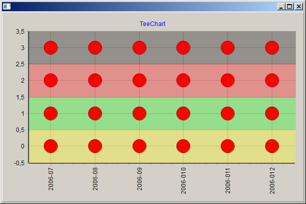

I still think the best option is using ColorBand instead of a series. Note that in the example above we've set the tool to use the left axis and we've set the Start and End values for the tool to be drawn horizontally. If we set the tool to use the bottom axis, the ColorBand will be drawn vertically as the Start and End values would be from the bottom axis.
To achieve something similar to your initial picture, I'd use as many ColorBand tools as rows of points. Here it is a simple example:
	    int nCols = 6;
	    int nRows = 4;
	    for (int col = 0; col < nCols; col++) {
	        for (int row = 0; row < nRows; row++) {
	            if (col == 0) {
	            	ColorBand band = new ColorBand(tChart1.getChart());
	      	      	tChart1.getTools().add(band);
	      	      	band.setAxis(tChart1.getAxes().getLeft());
	      	      	band.setStart(row-0.5);
	      	      	band.setEnd(row+0.5);
	      	      	band.getPen().setVisible(false);
	      	      	switch (row) {
	      	      	case 0:
	      	      		band.getBrush().setColor(Color.yellow);
	      	      		break;
	      	      	case 1:
	      	      		band.getBrush().setColor(Color.green);
	      	      		break;
	      	      	case 2:
	      	      		band.getBrush().setColor(Color.red);
	      	      		break;
	      	      	case 3:
	      	      		band.getBrush().setColor(Color.black);
	      	      		break;
	      	      	band.setTransparency(70);
	      tChart1.getAxes().getLeft().setMinMax(-0.5, nRows-0.5);
	      tChart1.getAxes().getBottom().setMinMax(-0.5, nCols-0.5);

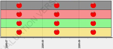

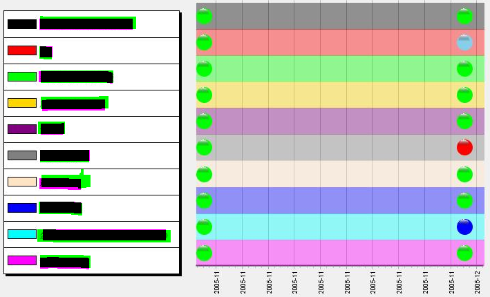

Thank you, Yeray. I took your advises and used ColorBand and dummy series. And they worked well. But after all that, I nearly forgot my original question, that is ,the aligning problem.....
I noticed that you used this method:
It behaves good, and I can modify my code using this. However, why my code doesn't work well? I'm using another method in stead:
DateFormat format = new SimpleDateFormat( "yyyy-MM");
      Date date = format.parse( "2006-0" + (col + 6));
      DateTime dt=new DateTime(date.getTime());
      //bubble.add((double) col, (double) row, 0.2, "2006-0" + (col + 7), Color.red);
      bubble.add(dt, row, Color.red);
In your code, you used "2006-07" as label, while I added it as DateTime XValues. Here is an instance I added two columns whose X-values are "2005-11" and "2005-12"(when adding one colum, the result is exactly correct):
As you see, the X-labels are repeated. It seems that the program doesn't know a "2005-11" is equal to another "2005-11" :D

Posts: 9712
Re: Bubble-XLabel Aligning Problem
Post by Yeray » Thu Aug 18, 2011 11:50 am
Hello Helen,
Excuse me, I should explain it better :-P
When you add the values with label, the default axis style uses the series labels to draw the axis, so it draws a label per point. However, if you add the values without label, the axis calculates the labels considering the axis length, the minimum and maximum a the separation between labels to fit as many labels as possible. And note that actually one "2005-11" and the next "2005-11" aren't internally equal. They are different doubles but they are formatted following the axis labels DateTimeFormat. So depending on the DateTimeFormat, two different dates can look as the same (if ie, the hour, the minute, the second are lost).
Helen

Hello Yeray,

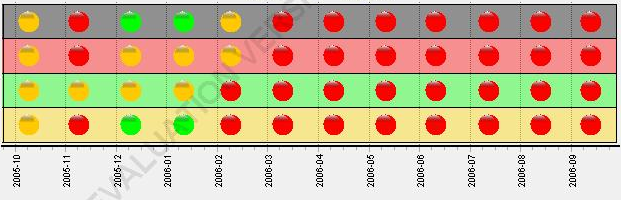

I got it.Your explaination is very clear. I finally got the right picture I want following your direction. And my team also got another problem resolved in the forum which is very helpfull.
Thanks for your time and patience, I really appreciate it.
