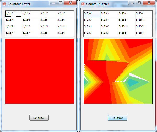

I have a simple project using TeeChart Pro VCL in Embarcadero C++ Builder XE. In this project I populate a Contour chart using values in a StringGrid. Problem is that sometimes the contour draws incorrectly. I have tried dozens of different approaches so far, but nothing seems to help.
I attached an image which shows the incorrectly drawn screen capture (left one) and correctly drawn (right one):
Here is the code that draws the contour:

Re: Contour not drawing correctly
Post by Narcís » Fri Apr 01, 2011 11:12 am
Hi kville,
I see two big differences between your application and Yeray's:
1. Your application has zero values after plotting all cells while Yeray's doesn't.
2. Yeray's application has a grid-like structure while yours has a more irregular structure. Here I explained how such series should be populated.
Both examples have different data so output won't be identical. I attach 3 Excel files with the data in your series, your application after clicking ReDraw several times and Yeray's. You'll clearly see the differences I describe above.
Having seen that, I think your code may not be doing what you expected with your data, it doesn't plot the StringGrid structure which is seen on screen. My suggestion would be to rework your code so that it populates the series in a similar structure as Yeray's it should be able to be plotted in two nested for loops.
Also, something that enhances the output a little bit is changing the default value, for example:
Post by Narcís » Thu Apr 07, 2011 8:54 am
Hi kville,
I do not understand your point about me not populating the chart with nested loops as that is exactly what I do as shown also in the code sample in the first post:
Not quite, please check out the spreadsheets I attached in my previous post. You'll see your chart is not populating the series in a grid fashion. It doesn't necessarily need to be with nester for loops but it should have a grid alike structure.

Thank you for the Excel files, they were really helpful for pointing out why the population was unsuccessful. I actually thought that the chart was populated with 16 (4x4 grid) values all the time and did not suspect that the data corrupted such way.
Further investigation showed that the following code did not empty the series correctly (do you have any idea why?):
// Remove default/old entries from series
for (int i = 0; i < Series1->Count(); i++) {
   Series1->Delete(i);
I replaced it with this:
Series1->Clear();
The reason that I used the Delete was that earlier I could not get the Clear method to work. I think this was caused by the default C++ Builder options (Paths and Directories) being wrong. I corrected this later in the development to correct another problem and never understood that it could affect the Clear method also.
   Series1->Delete(i);
Answering for myself, the above will not work because if index 0 is deleted index 1 will become new index 0.
Series1->Delete(i);
This is a problem with series indices. As you remove a point indices change and so does Series1->Count(). It's easier to control using a while loop:
	while (Series1->Count()>0){
		Series1->Delete(0);
